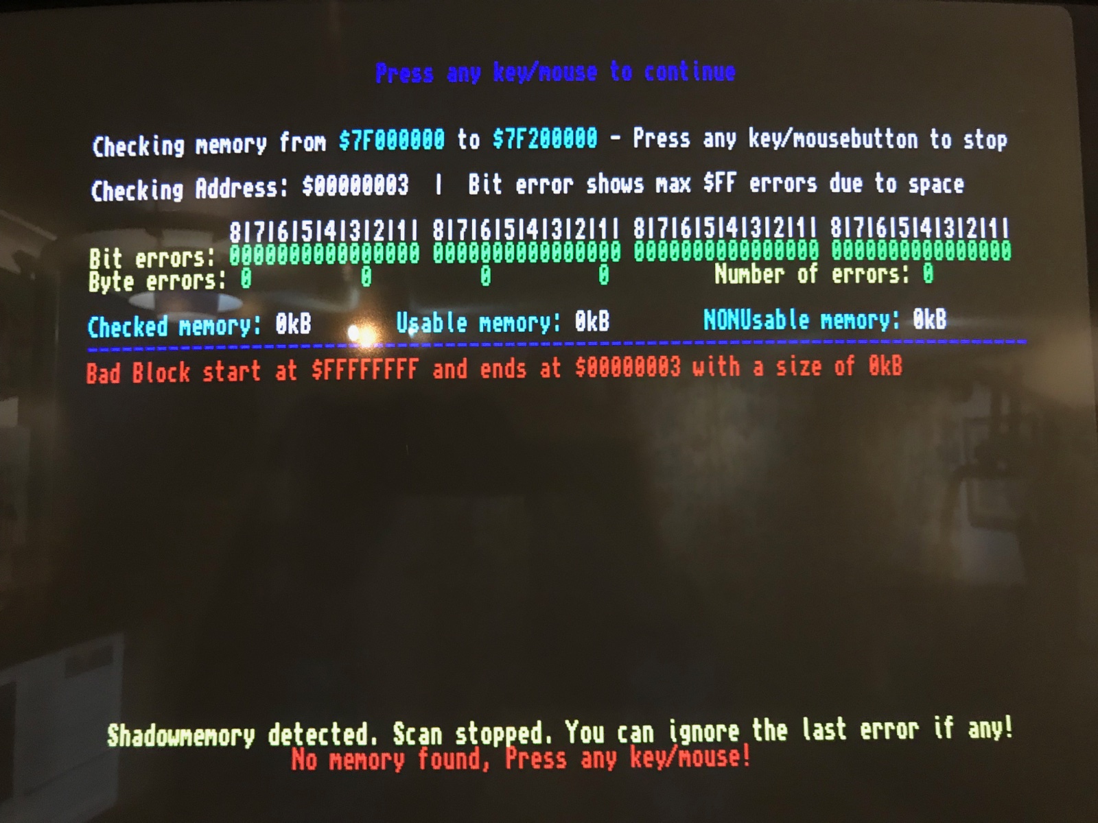

Finally I'm getting back to the TF536. I made a new riser from Lemaru's design on github, sanded down a new Augat PLCC socket, plugged in my 68030... and blow me down, DiagROM booted! 68030 success!
2M chip RAM scan is just fine. Fast RAM tests fail instantly, though I did buy and fit new RAM and after minute inspection I don't think there's any kind of problem with the soldering.
Any hints on what I should see from DiagROM or where to look if I get no RAM test progress at all?
I have inspected, reflowed, inspected again - no change. Reprogrammed CPLD with firmware from viewtopic.php?f=93&t=3438 - no change.
Edit: Working, after replacing the four buffer chips below the RAM. I expect they got cooked when I removed the original RAM that I installed the wrong way around.
