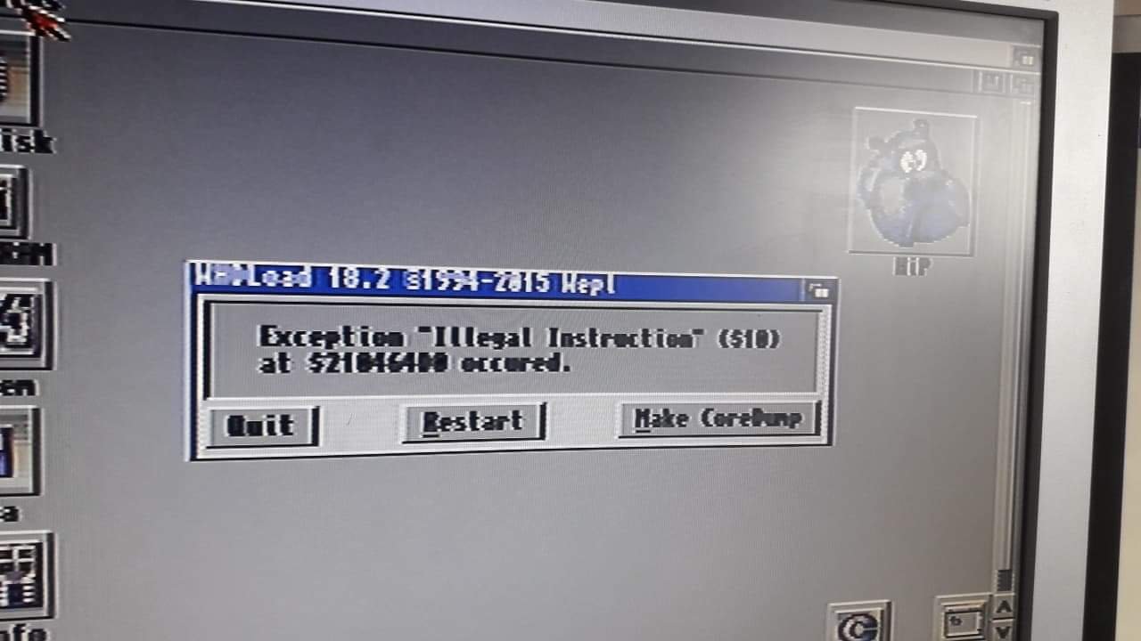

I install classic WB version litle
Still have problems
Now even I have white screen
Dnt know what could be wrong
Please give me some advice
I add all my errors what I get
