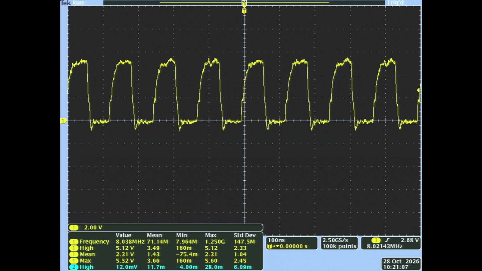

OK, here's without anything.

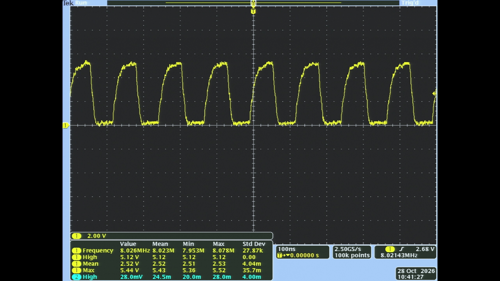

And now with 47pF cap and 500 ohm pull-up.
Screenshot 2026-10-28 09-45-46.png (1.11 MiB) Viewed 8 times
No kinks in the rise.

Re: General Stuff(tm)
Cool, thank you. I can see why it may glitch and cause issues.
