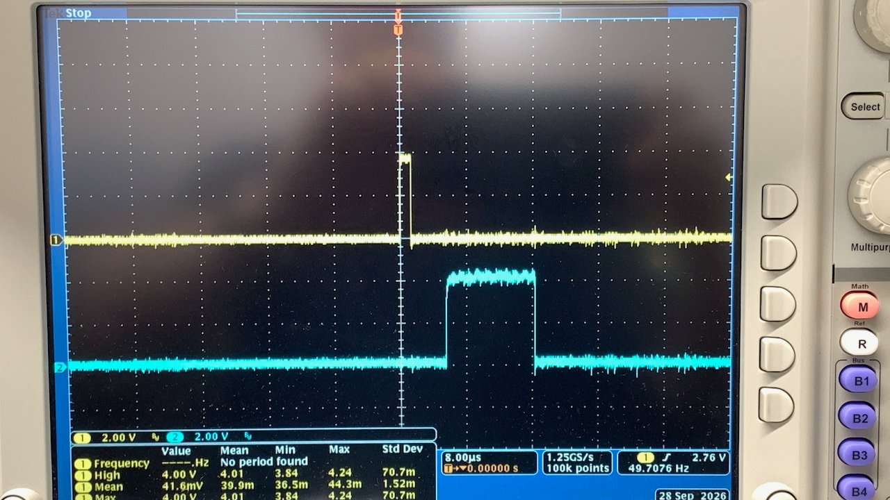

This is probably why the bus isn't getting held up correctly... The cursor signal from the 6845 never overlaps with the pulse allowing the 4538 to raise the bus request line. They miss by about 2.8uS.
