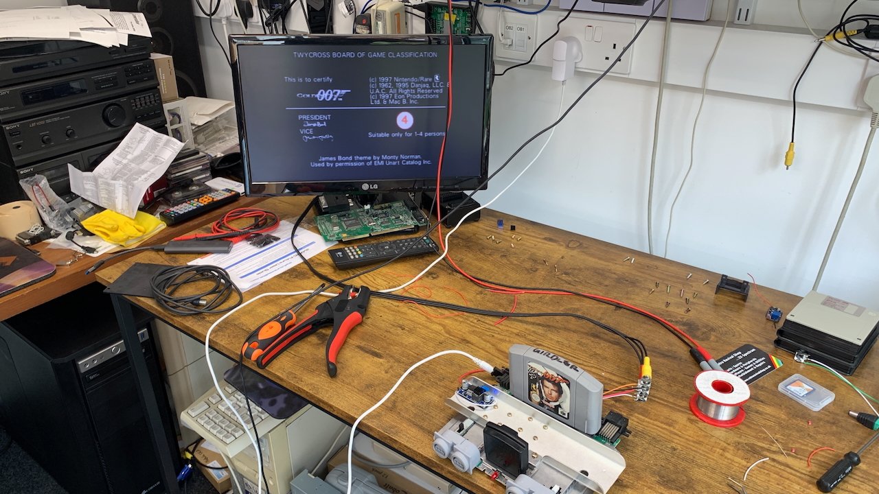

Anyway, the Spectrum mostly worked off the bat. Just needed a clean and the caps on the tape PCB replacing then it was happy.

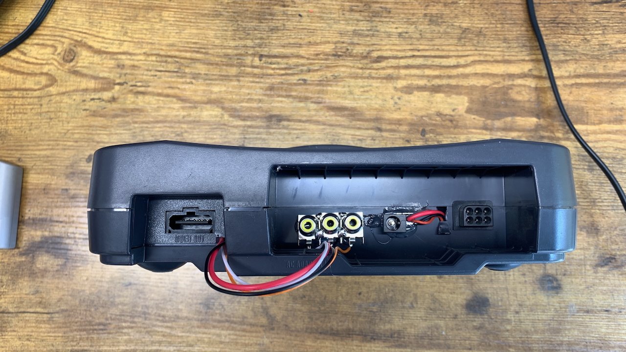

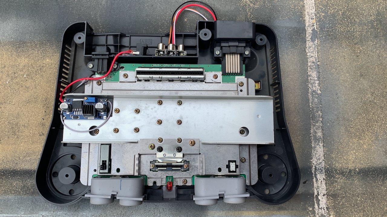

The N64 was more of a problem. Without the PSU, which provides both 12V DC and 3.3V DC it's hard to get it working. Similarly, without a special video cable it's hard to see if it's working. Thankfully there's enough info out there to bodge things.
The Kaiweets tool kit has a Nintendo special screw head so it was easy to get into the machine. I checked the PCB for leaking caps and there were none.
My plan was to make the machine run from purely 12V using a normal jack. I'd wire up a buck regulator as I have spare adjustable ones, and use that to power the main system. Easy enough to wire up by soldering under the board on the power socket connector pins. Similarly connecting some photo sockets.
Looks a bit hacky but it works.
Not having any controllers is a bit of an issue, so I've ordered a couple from Amazon for a princely sum of just over £20, so they must be top quality!!! :lol:
They should arrive tomorrow, hopefully, whilst I'm out. So, I won't really be able to test until Wednesday.
