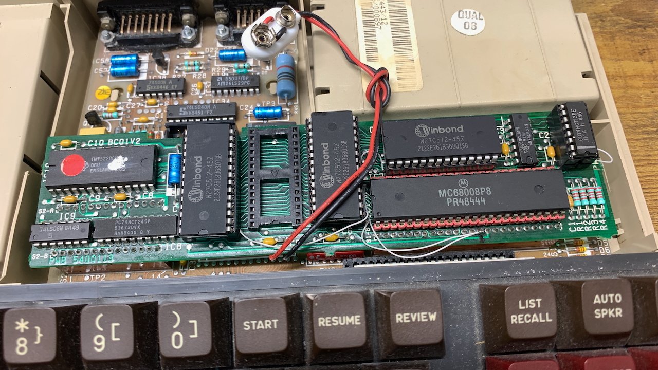

Reading the QL Forum I was reminded of a thread about doing a mod on the ICL One Per Desk CPU board to consolidate the ROMs into two 27C512s and add another containing ICL BASIC into one of the spare sockets.
Seeing as I had spare Windbond W27C512 chips and plenty of sockets I thought I'd give it a go.
Here's the original thread on the QL Forum: https://theqlforum.com/viewtopic.php?t=4676
Basically, you remove the original ROMs, socket the 74LS138 and bodge a couple of pins then program and insert the 27C512 chips, connecting pin 1 to pin 14 on the 68008.
The original description talks about cutting traces... I didn't go that way. Instead I modified sockets, plugged those into the PCB sockets and then ran bodge wires from bent up legs on those sockets. Anyway, it's easier to see than explain.
And... It works!
Despite the original thread noting that for the poster a Winbond EEPROM wouldn't work in the IC7 socket mine actually does.
This is a great benefit when using the Computer One disk interface as there's not enough RAM to load BASIC into it and then load any significantly large program into it, including the CONFIG and PRNCON programs needed to configure the hardware. With BASIC in ROM it's not an issue.

Interesting, I might take a look at that when I'm in possession of some free time!stephen_usher wrote: Mon Feb 02, 2026 9:20 pm Reading the QL Forum I was reminded of a thread about doing a mod on the ICL One Per Desk CPU board to consolidate the ROMs into two 27C512s and add another containing ICL BASIC into one of the spare sockets.
