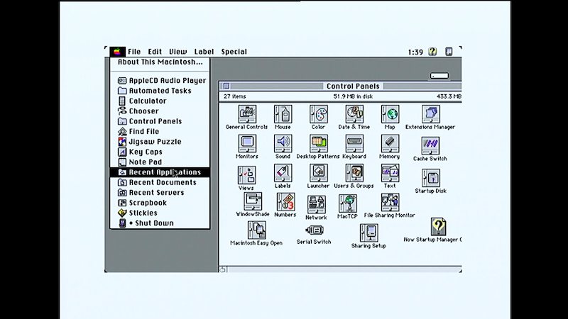

Badwolf wrote: Wed Jun 08, 2022 8:24 pm Still have the issue with the colour map seeming off for menus. Black on black when activated.
Is it just the top-level menubar, or is it the same for any highlighted item in the dropped down menu?
What happens when the Apple logo is selected? Does the entire section turn black including the logo or does that one stay correct?
I'll check. When I had these problems before I recall it also affected Civ's introduction -- I didn't have a chance to try that yesterday.
I take it there's no difference for the colour issue if you turn off CMP emulation?
Correct.
Posts: 3195
Re: Basilisk II Atari
Icons seem unaffected:
With neither MMU nor CMP selected (yes, I know...) it works as expected:-
So, by clever process of elimination, it looks like it's the MMU logic (this is CMP only ;) :
