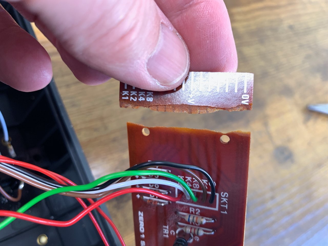

Well, the hand-held controller works but the desktop slave unit has an issue... the single sided edge connector seems to have broken off the PCB inside the unit. I'm going to have to drill out the 7 rivets holding the upper and lower cases together to get in side and see just how bad the damage is. It may take bodge wires and glue. Who knows?

Well, I wonder what could be wrong here? Not sure.
Anyway, used superglue on the paxalin PCB and then some epoxy and some old 3D print stuff for extra strength and then used solder to bridge most of the track breaks with only one needing some wire.
Put the unit back together and it works fine. Yay!

Nice save, but how did it break in the first place?
- Posts: 7626
Re: General Stuff(tm)
That board has a block with a double edge connector connected to it and that is supposed to push onto the PCB in the master unit. Could have been pushed together in the wrong way very hard.

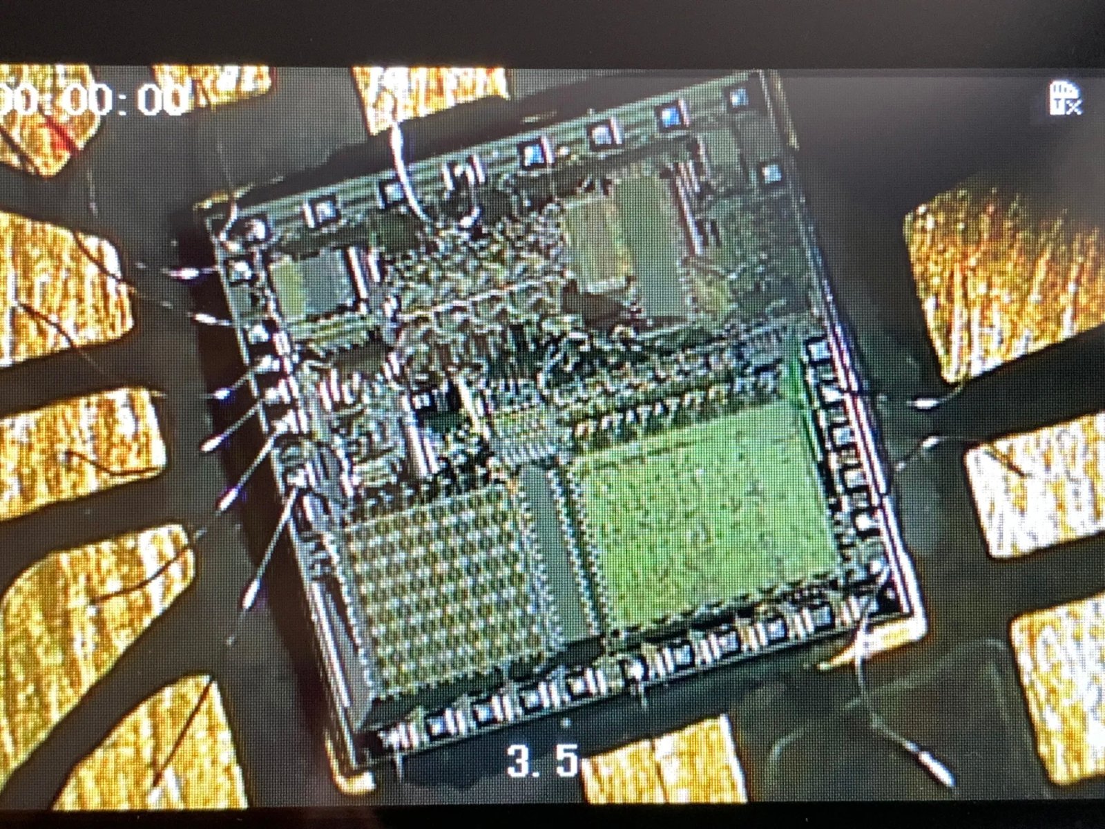

Oh, here's what a Zero 1 decoder "chip" chip looks like through a cheap digital microscope...
I took the plastic top off "in antiquity" before I knew what I was doing. I think the thing still works though.
