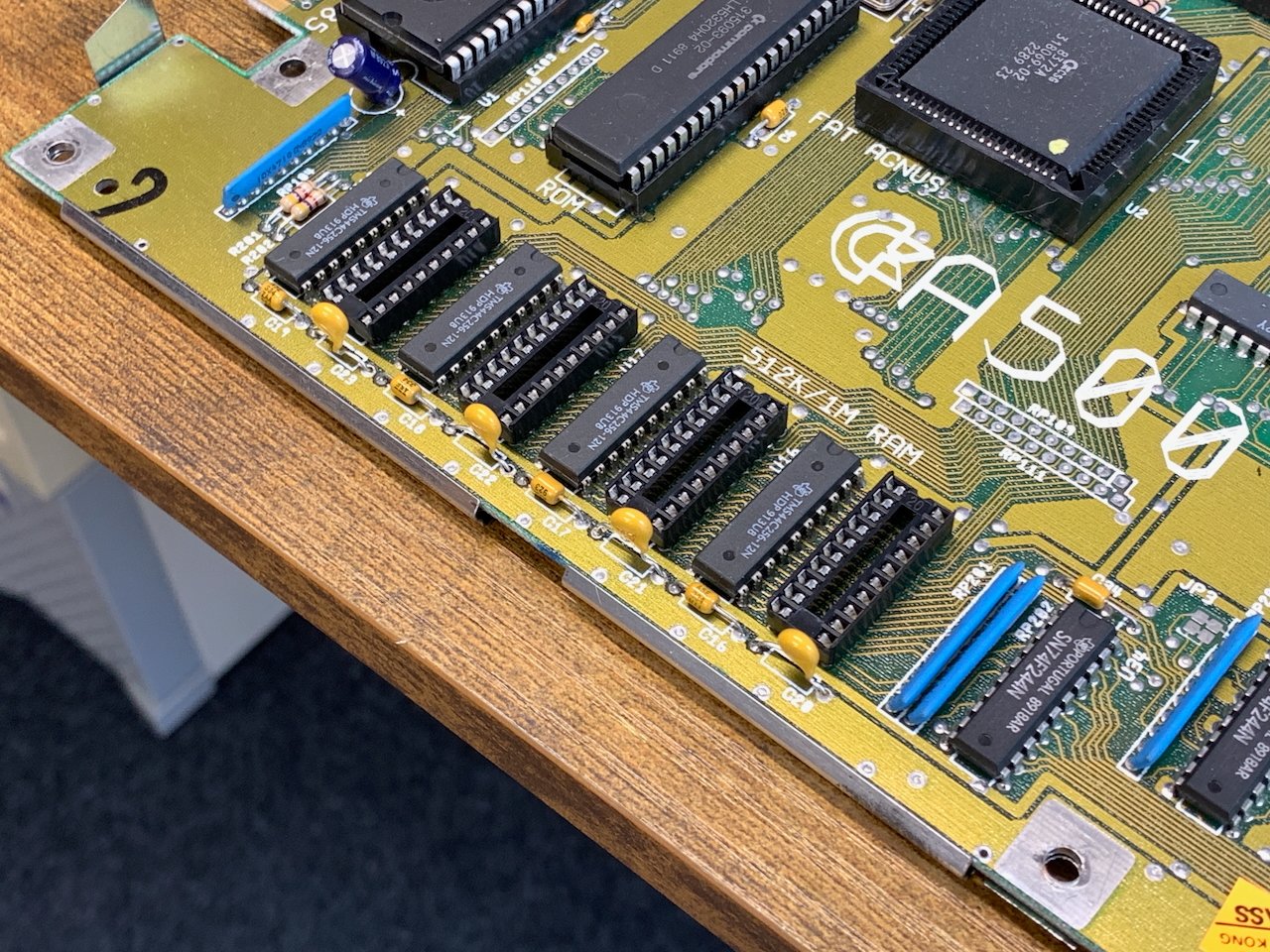

Stage one of the memory upgrade complete: Sockets and bypass caps installed.
All checks out so far.
Just need the actual RAM chips to arrive now, which may take a few days.

Given that I'm not going to get the RAM chips for a little while I desoldered the ones from the trapdoor RAM card as chip RAM is more useful than slow RAM.
After fitting them I changed JP2 and low and behold I now have 1MB of CHIP RAM.
I didn't touch JP7A as looking at the schematics that only involves the clock pulse (EXTICK) and JP7B is set to use the sync pulse for that anyway, so there's absolutely no point in changing that. The guides on-line seem to have mistaken what that pint on the expansion port is for.
The one issue is that the sockets raise the height of the RAM high enough that there's slight interference with the metal shield and hence the keyboard, but as it's sub-millimetre it's acceptable as the keyboard does push into place with a small amount of force.
I'll fit sockets onto the RAM board so I can fit the new RAM when it arrives. I can then see if 512K of SLOW RAM appears in addition to the 1MB of CHIP RAM. If not it's no real loss.
