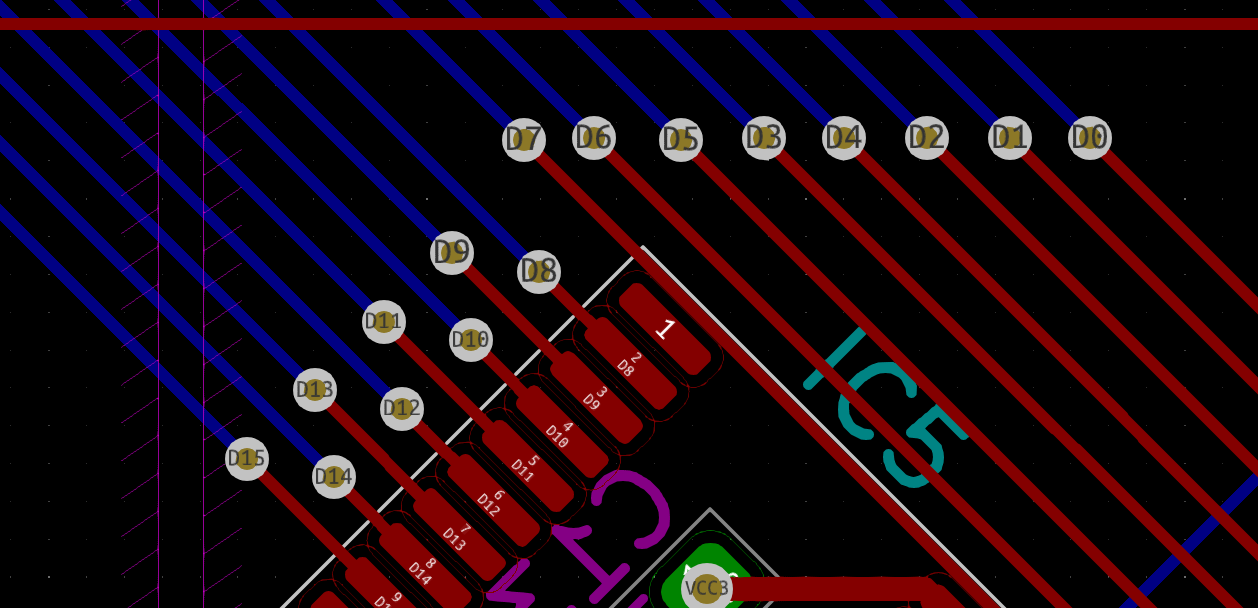

I suppose as the data buses on the small connector, a duplicate connector there for the other 16 bits would probably be the most convenient way of doing it.. Rooting it probably not so convenient...
ohhh look the other side of the databus is sitting right there !

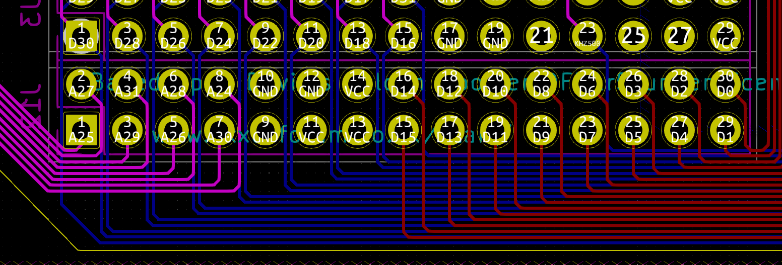

Ah, no I was thinking more about a bolt-on board that wouldn't need mods to the existing design.
Some kind of madcap thing like this with magical routeing of 68 lines through the gaps. :P

I've done it here on the FPU as it has all the lines and fewer pins, but I know DFB1X is SMT for that.

Badwolf wrote: Thu Sep 24, 2026 4:26 pm Ah, no I was thinking more about a bolt-on board that wouldn't need mods to the existing design.
Good luck with that one :) could probably be done if you push to enough Layers , but that's its own drama.. Probably be cheaper to respin the whole board and start again at that point :P

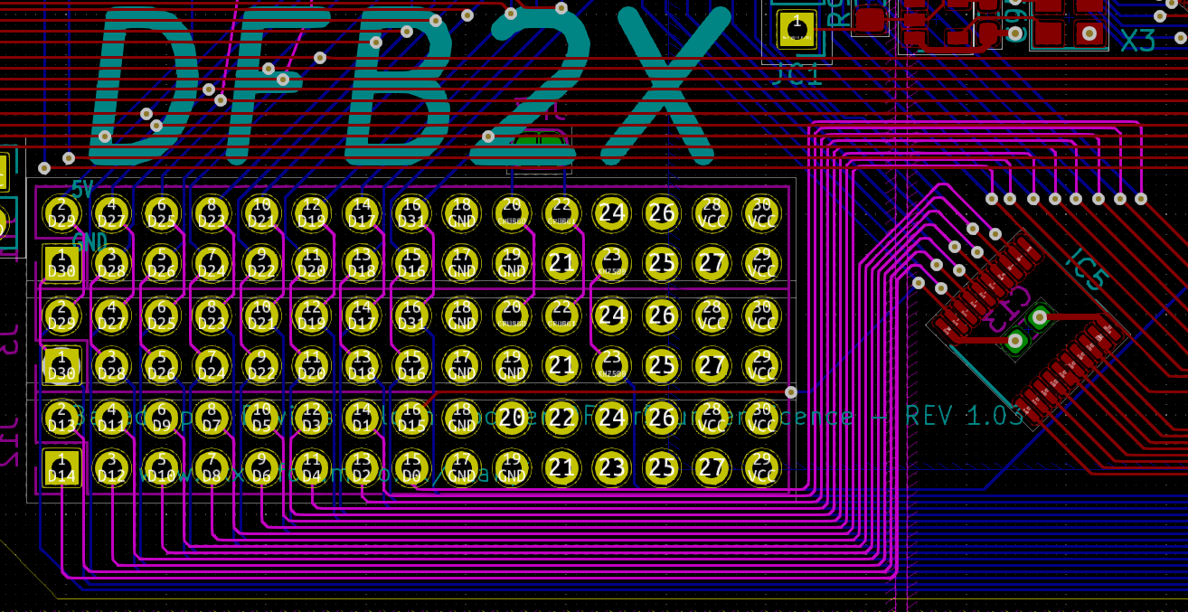

High address lines now rooted to the connector :)

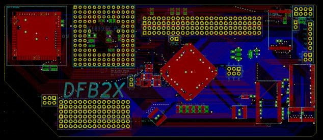

So this is all I'm going to do for this board revision.. Of course there has to be something meaningful to actually plug into it to make it worthwhile doing this design, but this would only happen after all the current DFB1X have sold anyway..
So basically this design has a clone of the Falcon RAM expansion port built on. As said before it had to go "above" the existing connectors. And then the third small connector on the bottom left holes the rest of the address and data bus bits. I also routed the CPUCLK to pin 24 of the "extra" IO connector.
