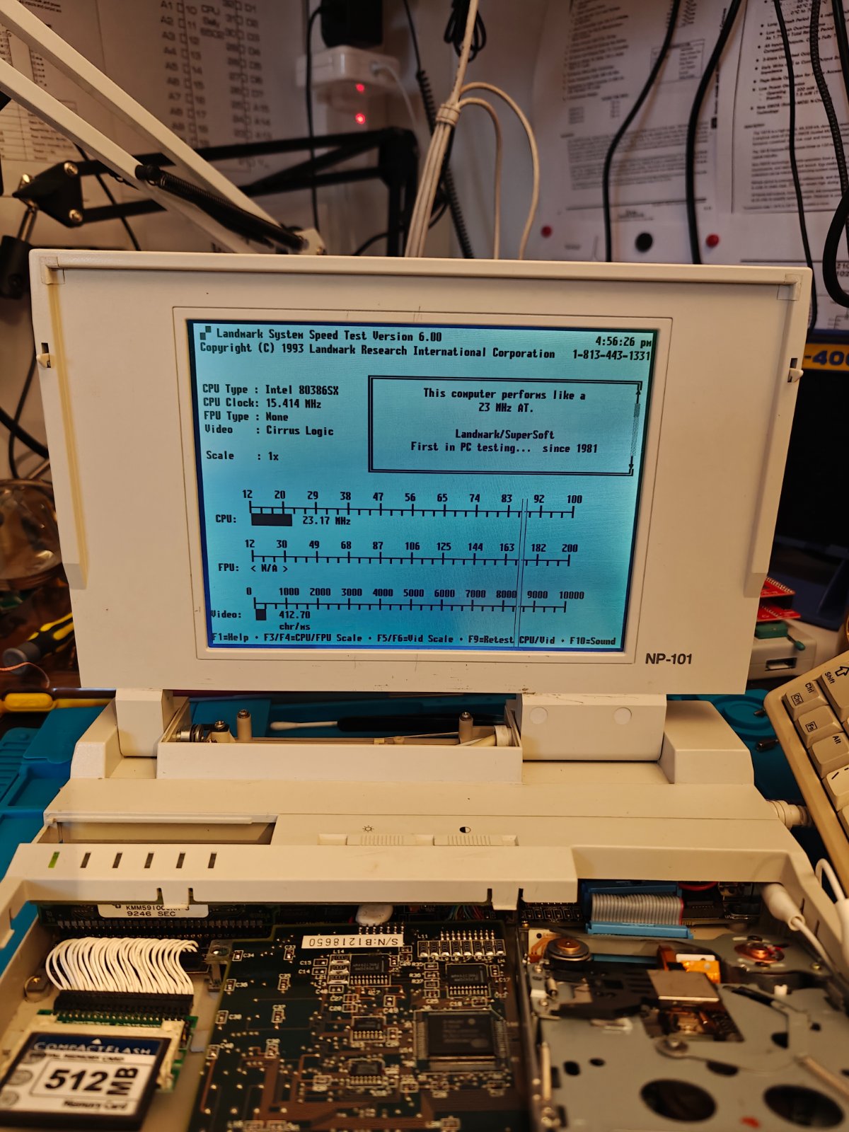

OK, so what I have is some progress
Sadly not on the FDD front, but definitely on the booting front.
I borrowed the 512MB CF card from my Book 8088 and set the BIOS to an appropriate size:
And it booted just fine
Whilst looking at the HDD config in the BIOS I also found that it's limited to 1GB, so whilst the 128MB & 512MB cards work, my spare 2GB cards won't, the bios simply won't allow for any larger.
So I need to see if I have any 1GB cards at the back of the drawers, and if not I may have to pick some up. I may also look at finally getting my XT-IDE card built as that may allow me to set up new CF cards in my Amstrad Alt-386, which has ISA slots being a luggable.
It may also be that whilst the Libretto won't see the 128MB card, it may see 512Mb or 1GB cards since it does see the 2 GB cards.
If I can get it running at least, it means I don't have to rely on the FDD for getting software on board.
