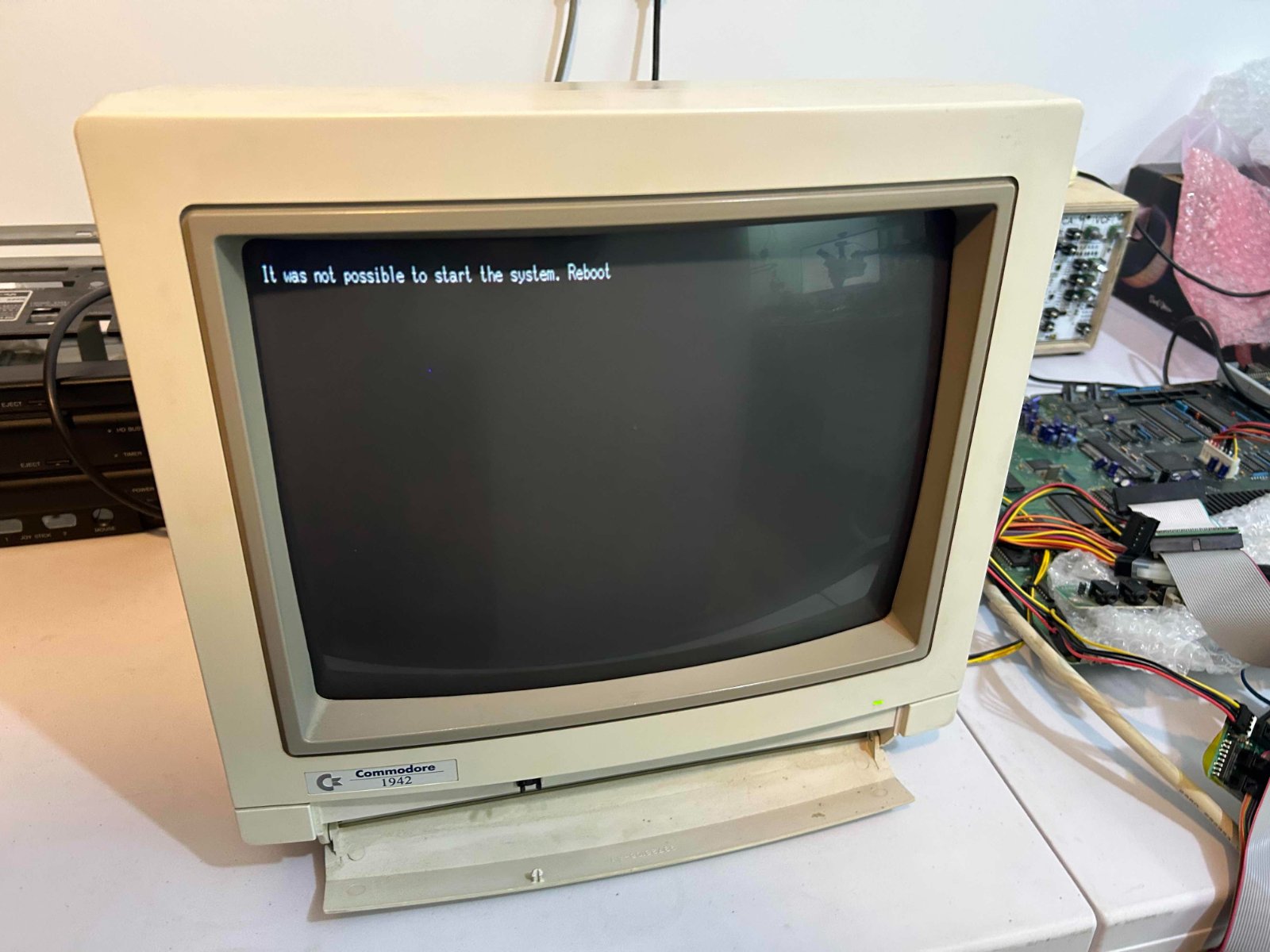

So a few bits of wiring later and ...
WhatsApp Image 2023-12-23 at 22.00.12.jpeg (338.03 KiB) Viewed 4979 times
I have an inline floppy adaptor thing and several goteks. But so far no luck in this department.
Higgy
Posts: 490
Joined: Tue Apr 23, 2019 8:05 pm
Location: Somerset
Re: A X68000 arrived
Post by Higgy »
Super. Now your into the realm of configuring the SRAM.
You will need to boot the 'Masterdisk V2'. And load Switch.c to configure.
Gotek, I guess they are flashed with Flash floppy. So can use X68000 images converted to .hfe
I am struggling to remember and currently watching a film with the misses so will look into it tomorrow ;) but your not far off now.
If it boots a disk that is not the right one, you might see a message with 'Human.sys' least you then know it is reading disks.
Update: Film finished, having a look now and my Goteks have S0 and S1 jumpers fitted. No MO or JC.
I can Attach my Masterdisk disk image tomorrow. Sharp released everything public domain so should be no issues attaching :)

Right so i cycled through the disks and they do get read. Only memtest actually works. The first three disks give
Memtest seems to work...
And the other 2 disks (unsure of what they are as its just gotek numbers)
