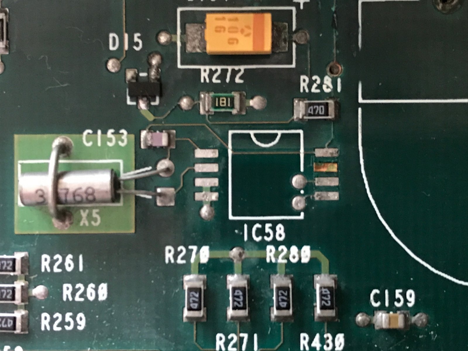

Ok, so here is what yesterday's repair look like:
Will have to scratch the epoxy residue and maybe trim the pad a bit.
This one is ready for soldering.
The RTC chip should be delivered tomorrow, and as I already have the 2 74HCT245T buffers, solder session should begin soon.

Very nice pad repairs, much neater than mine, though it looks like yours had the battery removed good and early and damage was minimal.
As @alexh mentioned, my FPU socket had damage underneath, but since the FPU is so expensive I opted to not repair mine, but it is in a position where it can be quite quickly if I change my mind.

As you mentioned it, the damage caused by the battery seems minimal (compared to what I had in my A3000) and the board looks quite good.
I also cleaned today the inside of the case, the floppy drive and the external fascia.
Everything looks much more better now, despite the visible yellowing and other scratches.
