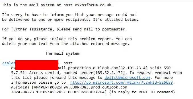

I am still battling this in the background about Microsoft rejecting emails from my server...
The thing is, my server IP address changed a few months ago with the server upgrade but the new IP address also seems to be blocked by Microsoft :roll:

Andddddddd banned again!
