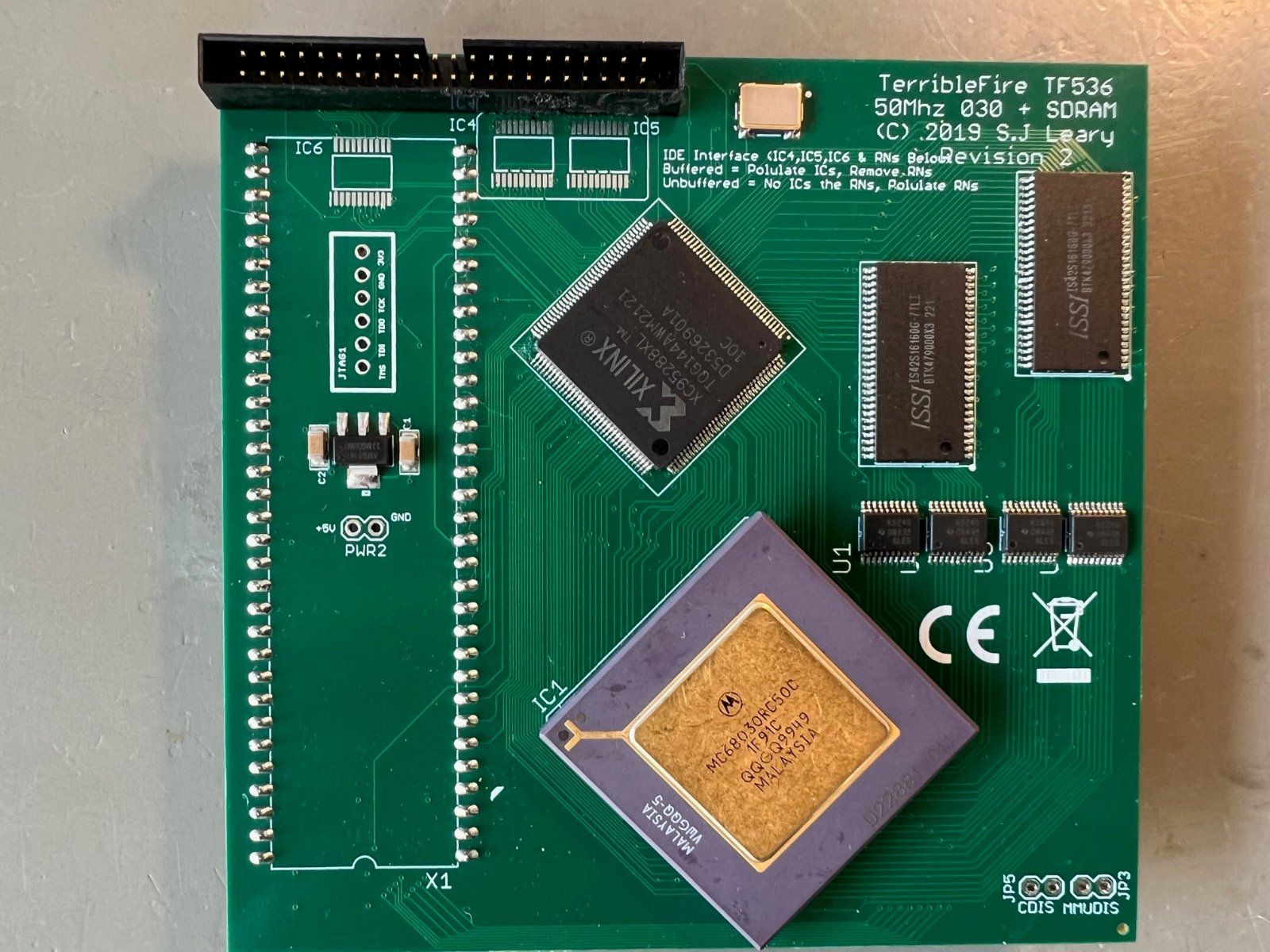

terriblefire wrote: Tue Jan 03, 2023 10:48 am Is your board 2 or 2b? Plain rev2 will not work with buffers but i've no idea how you got it if you did. There was only 10-20 of them made.
It is plain 2 I guess :-(
I bought it from Retroguru.eu in october 2022.
I guess I'll try to modify the connections for IC6 to match the rev 2B...
My board:
download/file.php?mode=view&id=29370
TF536 R2.jpg (335.45 KiB) Viewed 3664 times

Hsommer wrote: Tue Jan 03, 2023 11:20 am It is plain 2 I guess :-(
Yeah that one will not work with buffers. IC6 has a bug that was fixed. However its not unreasonable to be sold that card as it works perfectly well as it was sold to you. Its just one of the very first batch of rev2s. There is a thread on this site somewhere with the mods needed. Its just a case of shorting something to VCC.
Here is the link to where the mod for early rev2 (non-b's) is.
https://www.exxosforum.co.uk/forum/view ... 110#p37329

TL;DR
Lift pin 1 (DIR) on IC6 and connect the lifted pin to pin 2 (VCC)

terriblefire wrote: Tue Jan 03, 2023 11:36 am TL;DR
Thank you :-)
The buffers work now...
Thank you for all answers in this thread.
Fair warning!
released gerbers are indeed revision 2, not revision 2b
ive just checked them here:
https://www.exxosforum.co.uk/forum/view ... 935#p75889
