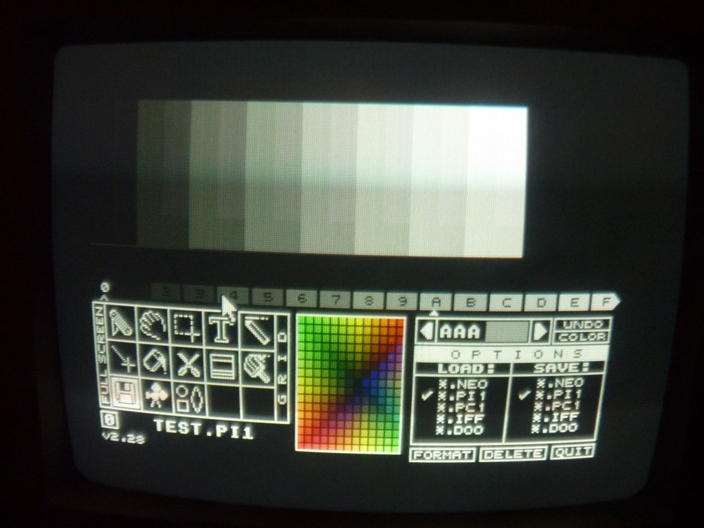

Now onto the greyscale test images supplied by @sporniket designed to show the STe palette shades and any differences with regards to the regular ST palette shades.
The first one, I will show another before/after set.
This was before:
And now:
I guess the levels are harder to differentiate when all 3 RGB channels are involved and at higher values, but I believe there is slightly more of a clearer channel value definition on the later image.
