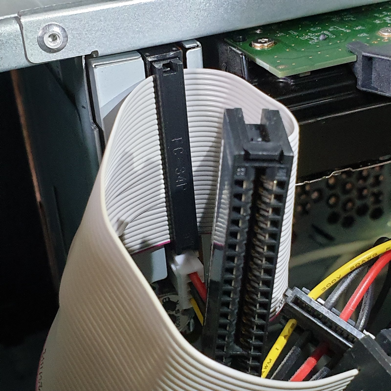

ThanksCosmic Puppet wrote: Wed Apr 07, 2021 3:17 pmWill do. I need to shut the computer down and open it back up.rubber_jonnie wrote: Wed Apr 07, 2021 3:08 pm I need a photo of the drive connected to the GW. I need to see the connections between the FDD and GW and power, with no background clutter please

Plugging in with red aligned to triangle.
USB plugged in and going to the pin header that previously had satisfactory results.
I now get this:

Ok, so the connections look ok for the power and 34 pin cables.
