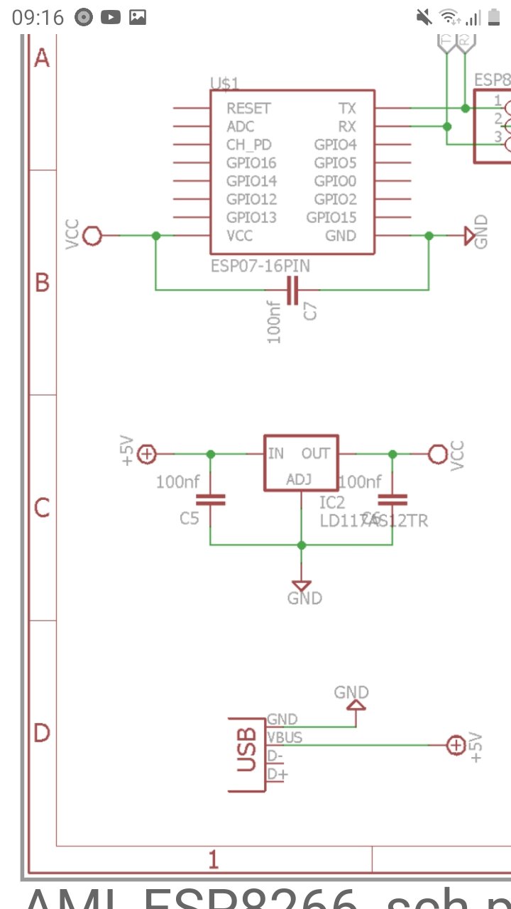

On my schematic is VCC = 3.3V
Screenshot_20200416-091645_Samsung Internet.jpg (66.39 KiB) Viewed 4494 times
