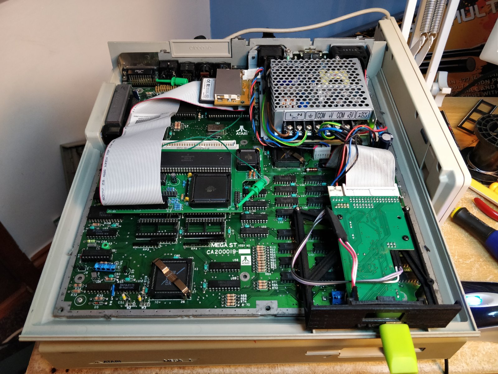

Here she is in all her glory:
I think it's been worth the struggle:
Replaced missing AY chip and replaced broken tracks with wire.
Removed CPU, fitted socket and added IDE interface with TOS 2.06/1.04.
Added CF adapter as hard drive (HDDRIVER 11 now in use).
Fixed damaged floppy power lead.
Replaced missing floppy drive with a Gotek.
Replaced missing Blitter.
Made new RTC wiring harness.
Replaced faulty RAM chip. (Hidden under the Gotek!)
Replaced PSU with Meanwell unit.
Had a massive troubleshooting effort (Thanks for everybody's help!!) which led me to a bad GND connection on the LO0 ROM which prevented boot.
Along the way fitted replacement DMA and Shifter sockets to replace the cruddy original ones.
Last but by no means least, I found out it's really difficult to find a Mega ST keyboard. Since I also have a Mega 1 which is sans keyboard as well, finding two is nigh on impossible!! Like rocking horse sh*t as a good friend once said to me.
All in all it's been a ton of frustration, a lot of fun, I've learned a ton about troubleshooting the ST and I'm happy to have a good working stable Mega ST 4.
