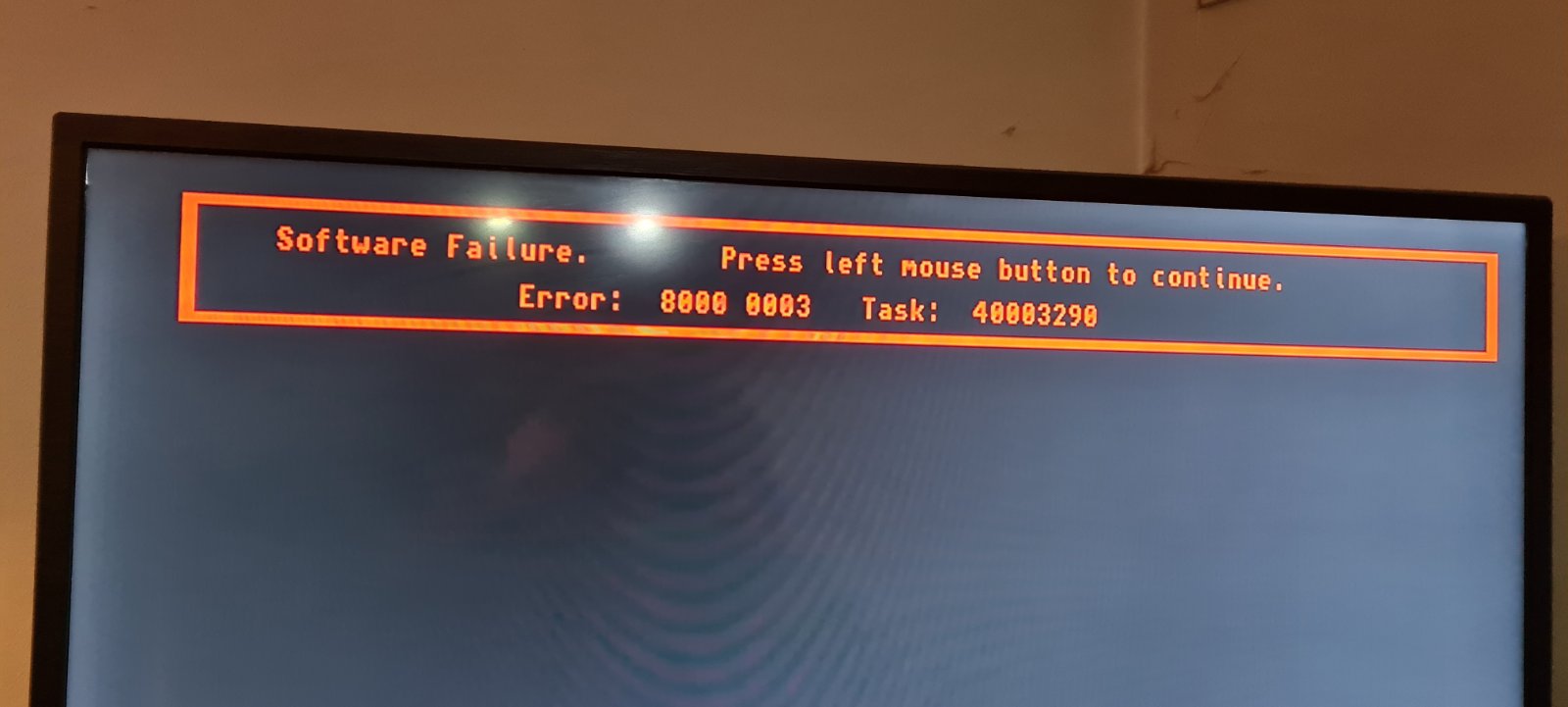

Re: TF1230 Beta Interest (Open Source)
This photo is for Board 1d4 kick 3.1
Reamiga start booting
