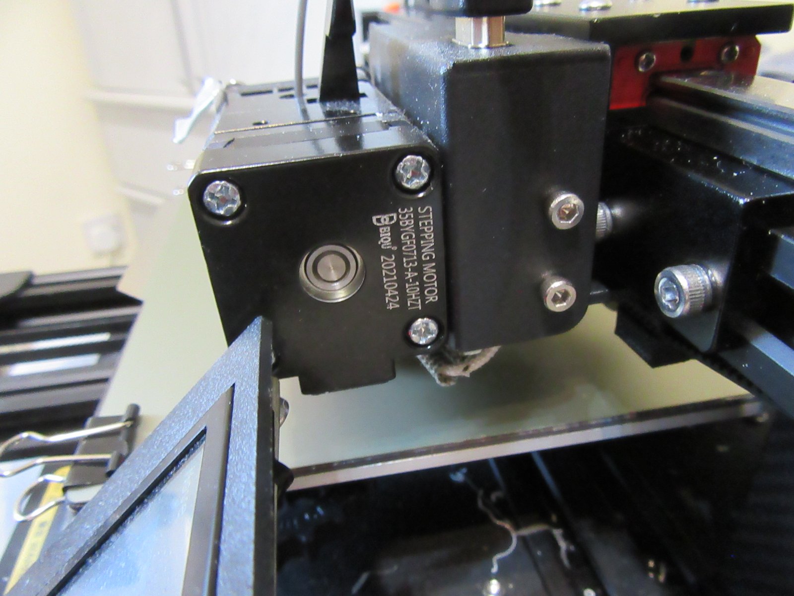

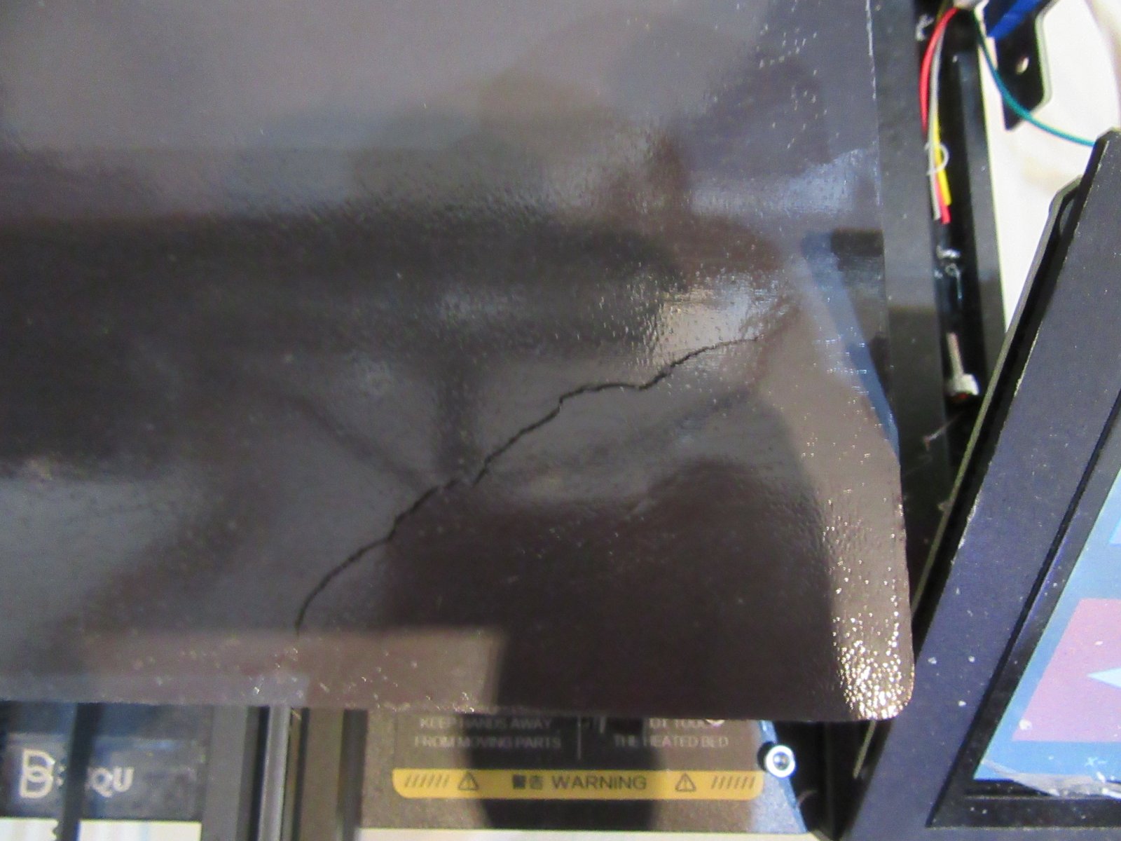

Anyway, it looks like the magnetic bed has already cracked. I removed the original build plate and fitted a "better" one. I also had to move the display forward to little bit because the X-axis was also sticking out further than it was originally.

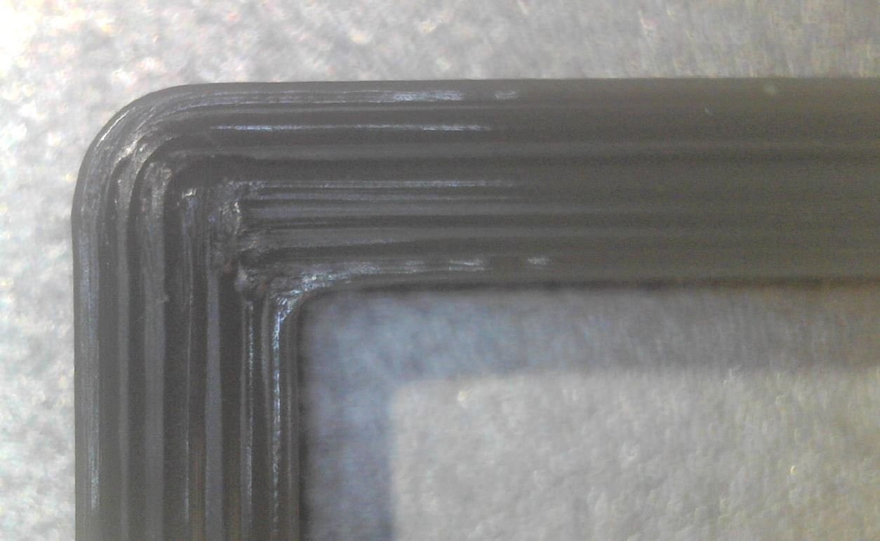

I am seeing some odd banding which I'm not sure where it is coming from currently. It is not relating to the speed as I have slowed it back down the problem is still there. Though am printing "inside out" so I'm going to try "outside in" as it may well solve the outside edge problem anyway.
The banding looks like it was mostly due to the cooling fan was turned off totally. I turned it on about halfway, and the top half of the print is a lot better now!

Being experimenting with various settings the past couple of days. Mostly I found slow acceleration of about 200 creates this mess as shown below..
So now working on the principle of 8000mm/min print speed and 1600 acceleration. Basically the acceleration being x10 less, then doubled
Things are definitely looking a lot better with those settings.
