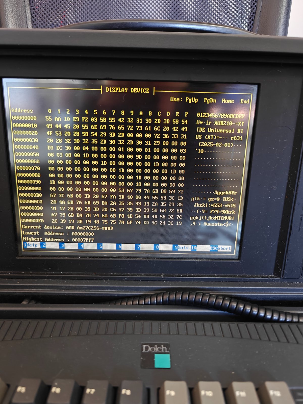

Got this hooked up to my Dolch L-PAC 486:
And it happily read a 27C256 :)
I've yet to try programming, but I expect it'll be just fine :)

On a positive note the ROM programmer works great, at least for reading and writing 27C256's :)
