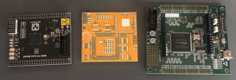

Well we didn't stop there we had an idea about using a Max10 dev kit board with a modified buffer board from the Blitter board design so we could easily plug into all the chips (MMU, GLUE & Blitter) to try out just by modifying the firmware / core. This way we would have a solid Max10 board to work with.
We looked at many different boards and some are very expensive. e.g. we found one that fitted the bill i.e. enough IO pins on its header and even had 5V to 3.3v buffers built in. Unfortunately the cost was £300+. We had a look at Intel's own Dev Kit (right one in the picture) which seemed promising was a little large but we soon discovered the headers did not expose enough pins.
Finally we went with the QMTech board (left one in picture) that was small, pretty much the same size as the Blitter board, had enough pins and was cheap £16. We currently have a buffer board based off of the Blitter board being designed that fits on the Max10 kits headers. Once we get this working we hope to be able to plug three of these combinations in to have each MMU, GLUE and Blitter core running on real hardware.

Interesting name again.
Interesting that the right board didnt break out all the pins but does look like it was primarily aimed at the advanced Arduino user.
Re: BLITTER RE-CREATION THOUGHTS
Sparkalaphobia - the fear of Glitter
Yes it was odd especially as the Intel board has the bigger chip compared to the other board. Most of the header pins are either GND or non IO pins on the Max10. Yes it does have an Arduino footprint so you can put the many Arduino shields onto it.PhilC wrote: Sat Jul 20, 2019 11:45 am Interesting that the right board didnt break out all the pins but does look like it was primarily aimed at the advanced Arduino user.

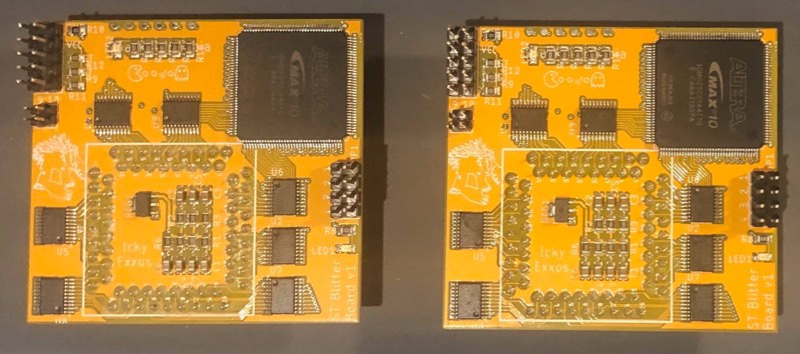

Just got these two glittery things made up. These are a newer revision of the original with the regulator fixed from the incorrect eagle footprint and the patches from the first one built into the board.
Will sort out the core pin assignment out and load it into the FPGA probably tonight.
