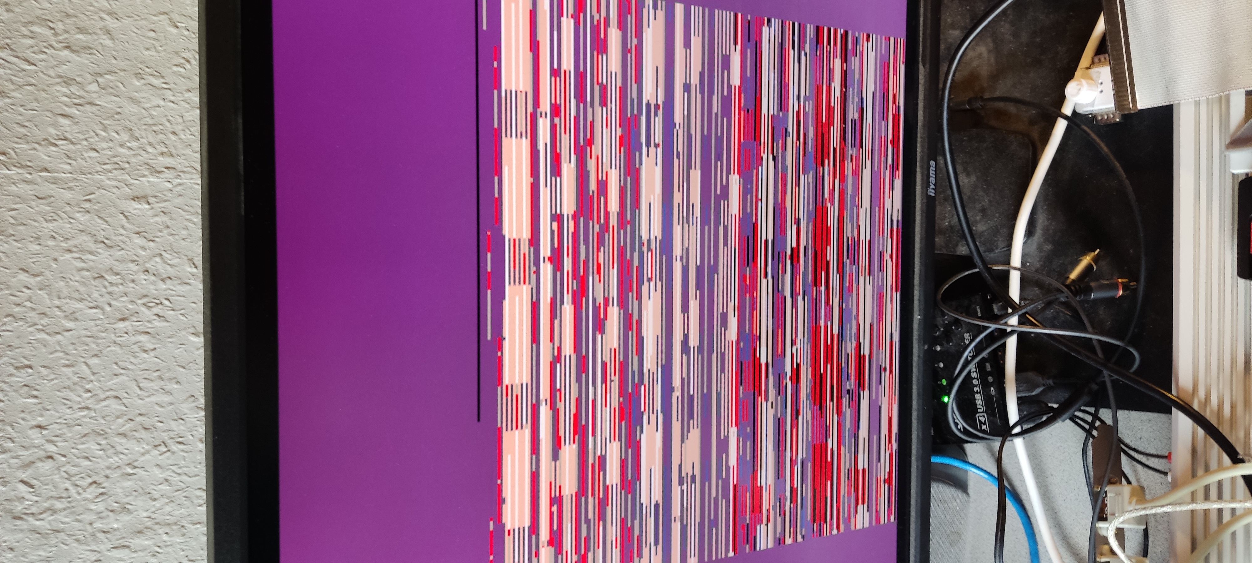

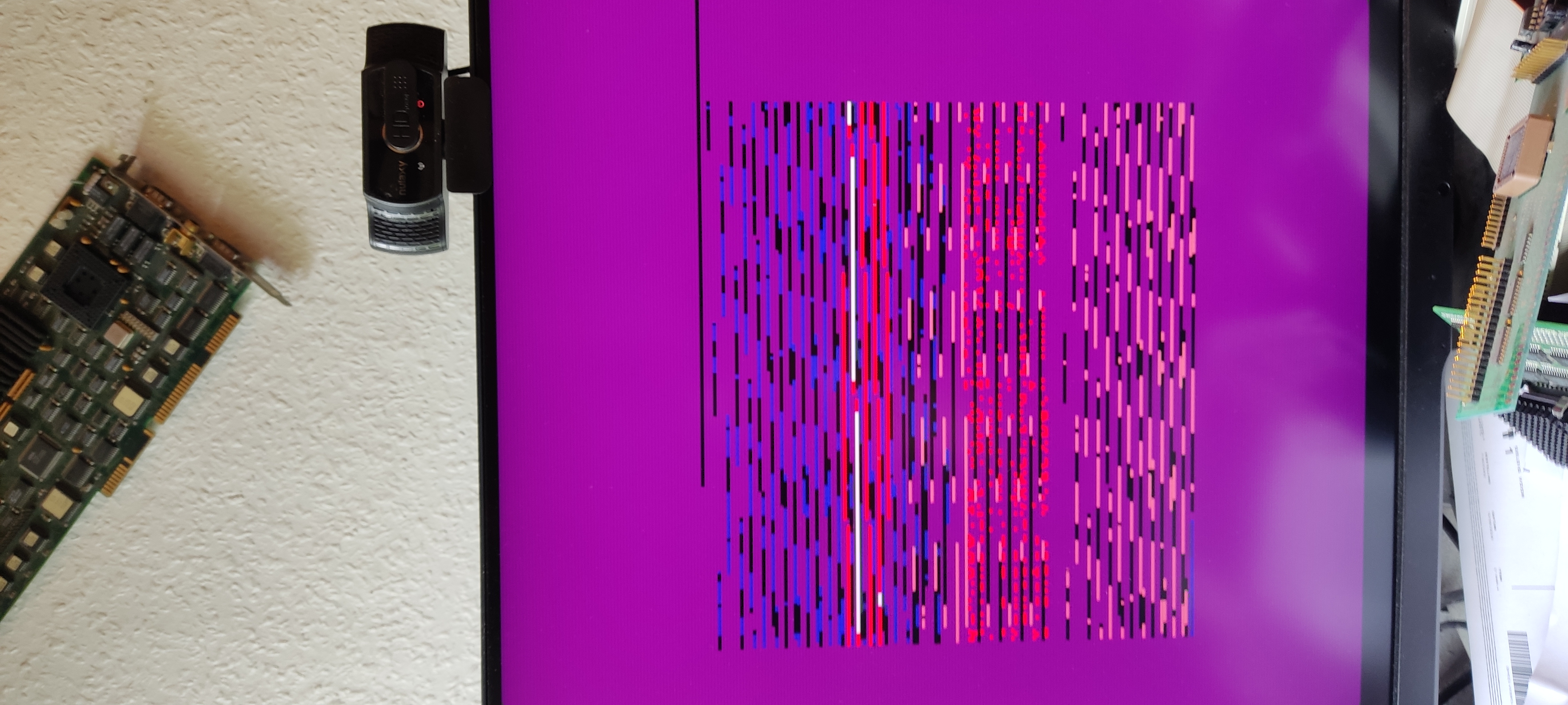

Hello together,
I just received my TF4060 and it seems to work in my A4000 Tower (Amiga Technologies).
But I have several problems.
When using the TF4060 IDE ehide.device the HDD will "hang up" after loading/reading from the CF card.
Not everytime for the same action, but i if copy files or extract LHAs it will the IDE device stops working (the system does not crash, mouse can be moved, but you can do nothing because IDE is not responding).
I tried several CFs / HDDs / M.2 etc. and several CF2IDE, M.2ToIDE and all the stuff i have here in my hobby room (and its a lot ;) )
Working from the internal IDE seems to work fine.
The system was rockstable before a Cyberstorm MK2 (wich had also problems, but that is another story).
I tried using KickROM 3.2 and 3.2.3, but that does not change anything.
No devices are connected to the internal SCSI.
I installed OS 3.2(.3) several times and also installed the recommended MMULibs as listed here:
https://alen.dreamhosters.com/terriblef ... tructions/https://alen.dreamhosters.com/terriblefire/tf4060-installation-and-instructions/
I removed all Zorro cards, the Indivision AGA, put a IDE Terminator into the internal IDE port and also removed the motherboard RAM.
But I still gets the errors after booting the system with the TF40460 you can see in the screenshots and short videos here.
Would be great if someone has an idea what could be the problem :D
https://theotheoderich.de/amiga/tf4060/ ... 100841.mp4
https://theotheoderich.de/amiga/tf4060/ ... 114350.mp4

TheoTheoderich wrote: Sun Aug 31, 2025 11:56 am Hello together,
https://theotheoderich.de/amiga/tf4060/ ... 113833.jpg
https://theotheoderich.de/amiga/tf4060/ ... 120946.jpg
I'm unable to access the media you attached to the post. So its better to upload to the forum.
If there is a ehide issue then its completely unrelated to anything else in the system. Can you send me a cf card image that reproduces the issue (as bare bones as possible ... put it in a download link) and tell me what firmwares you are on. I'll try to take a look this week.

TheoTheoderich wrote: Sun Aug 31, 2025 12:23 pm Thanks for your answer. I tried to upload the images to the forum, but i alway got this message :(
"Forbidden. Message seems to be spam. Anti-Spam by CleanTalk. "
OK i think I have a fix for this that came in after the A4000T support broke again.. Does this look like your issue?
