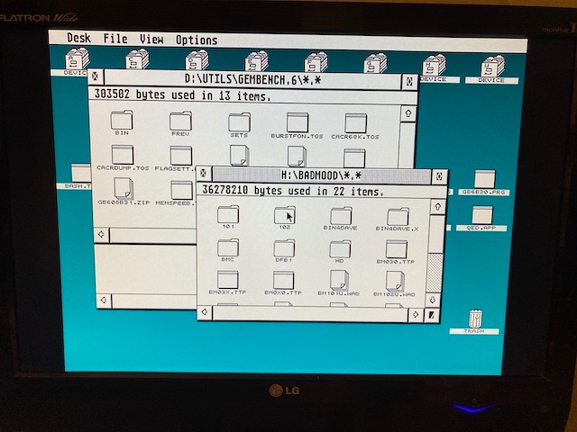

markus0321 wrote: 28 Nov 2022 19:39 I tested without MAPROM.
The system starts up but even with NVDI running there are graphic corruptions and when I move the mouse cursor to an item in the menu, bombs appear and the system freezes, other times it resets when hovering over the menu. :(
That looks like blitter corruption, which would imply NVDI failed to start properly.
I've got NVDI + TOS404TT booted up here without that corruption.
EDIT: here's the same boot but without NVDI. Looks familiar.
