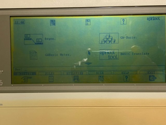

Well, well. The Apricot FP is actually significantly faster and more IBM-PC compatible than the F1/F2/F10 it seems. This is probably due to it having separate display RAM.
The F1/2/10 has a speed rating (when CheckIt! doesn't crash, which is most of the time) precisely the same as an IBM PC-XT. The FP is over 1.5 times this.
As for the system itself, I do think that there is a memory fault in at least one of the chips in the high bank. I wonder if any of the spare 41256 chips I have actually work. If I had enough I could upgrade the machine to the full 1MB by soldering in another 32 of them.
P.S. How did we cope with these early (1984 vintage) LCD displays?
