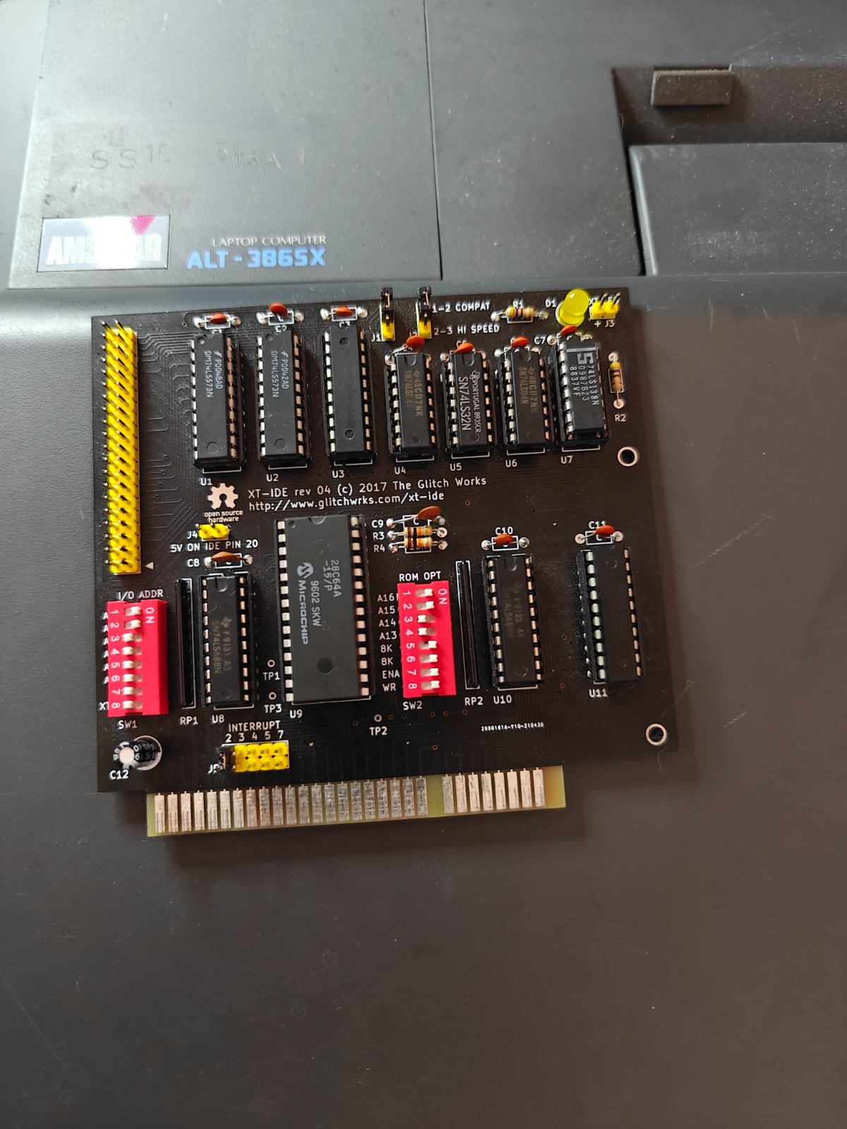

OK, so the XT-IDE is working to a point now @HigashiJun :)
It is a least working to a point, I haven't tested booting from this machine yet from a CF, but the ROM is working and shows up at boot time.
I wasn't able to write the ROM whilst installed on the board, but I was with my TL866 after auto configuring and saving the ROM file in XTIDECFG and copying across using a floppy disk. The process for that is interesting, but it works :)
