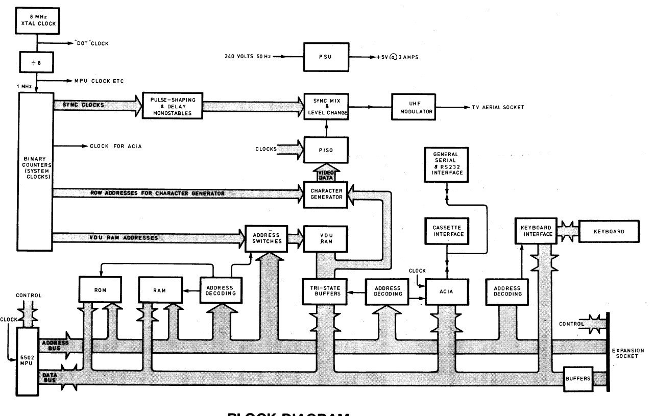

How is the video generated on the machine? Is it all TTL logic?
Oh, I've just had a look at the UK101 manual (https://uk101.sourceforge.net/docs/pdf/manual.pdf). Interesting design. Basically having the system clock selecting the character scan line row and the output from the RAM selecting the character.
Seeing as you have sync then the sync clock is working.

From the block diagram, even if the video RAM isn't communicating and the outputs from the counters are bad the character ROM will be outputting a value, unless you're really unlucky and it's always the SPACE character being selected. In which case it would have to be the chip called the "PISO" in the diagram not translating the output from the character ROM to the screen output.

Indeed, sync is definitely there, but no video. I need to look at all the parts that generate the display as that part is clearly not doing anything.stephen_usher wrote: Fri Jan 26, 2024 9:41 am How is the video generated on the machine? Is it all TTL logic?
Since there should be a display and characters on screen even without a CPU fitted, I'll focus on that first, it is test procedure 6 in the build manual. I should have done it sooner, but because all my parts arrived at random intervals I didn't, but hey ho.

I think the PISO is U42, an LS165. I'll give it a check later. I really should do some work now though!stephen_usher wrote: Fri Jan 26, 2024 10:37 am From the block diagram, even if the video RAM isn't communicating and the outputs from the counters are bad the character ROM will be outputting a value, unless you're really unlucky and it's always the SPACE character being selected. In which case it would have to be the chip called the "PISO" in the diagram not translating the output from the character ROM to the screen output.

Indeed, you should at least be getting horizontal sets of pixels being displayed even if the character ROM and video RAM aren't getting their addresses from the counters. Seeing as you say that the ROM data lines are active this means that it must be the encoder down stream, which is termed "PISO" here:
