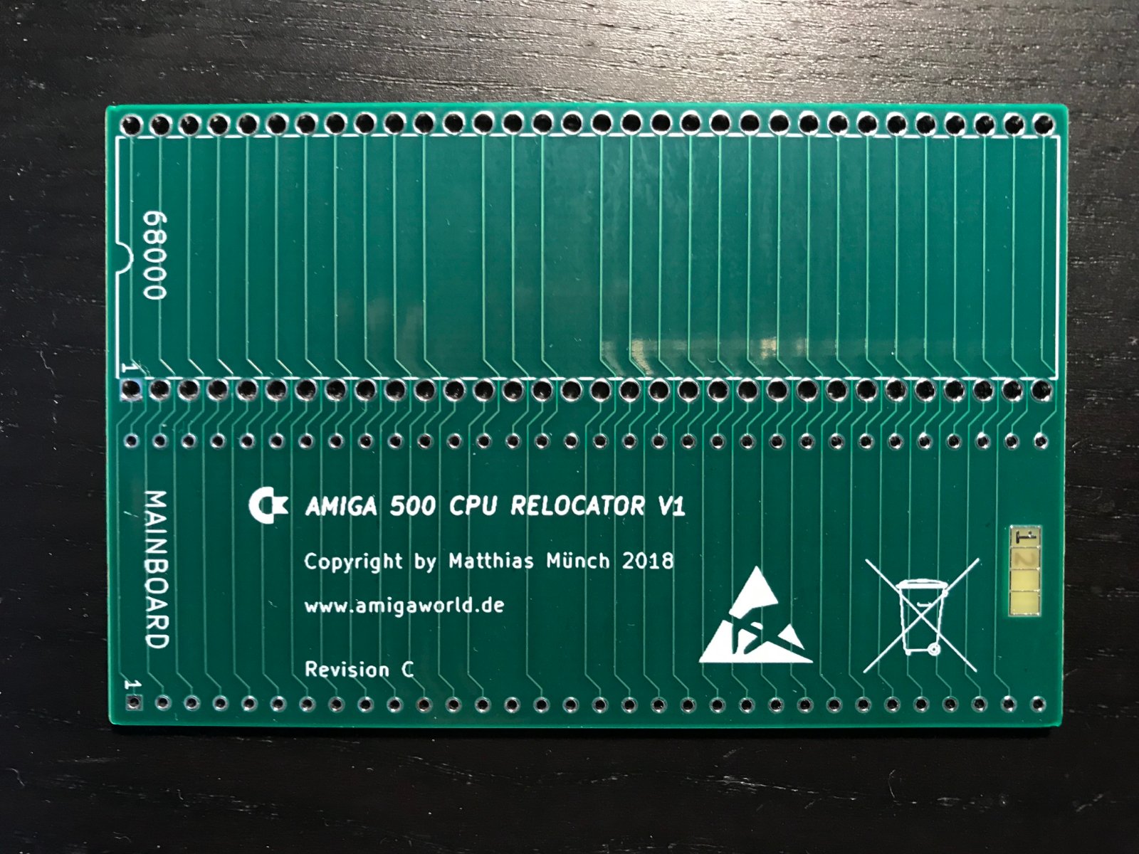

I have finally received today the 4 layers CPU relocator PCBs from China.
This relocator was initially designed for the Amiga, but as our machines share the same CPU, it is not an issue.
Once the DIL socket and headers soldered, everything was fitted back in the Mega ST.
Since this new relocator is 4 layers and is shorter than the previous one, I hoped I would not have any quirks but I was totally wrong...
Issues are completely different, and the only way to have a stable machine is to fit the PAK68 directly in the CPU socket on the motherboard, at least in my Mega ST.

What were the inner copper planes? Both ground or one power and one ground?

@stephen_usher
Seems weird, but I have just check the Gerbers and there is no connections for GND and VCC...
@czietz
