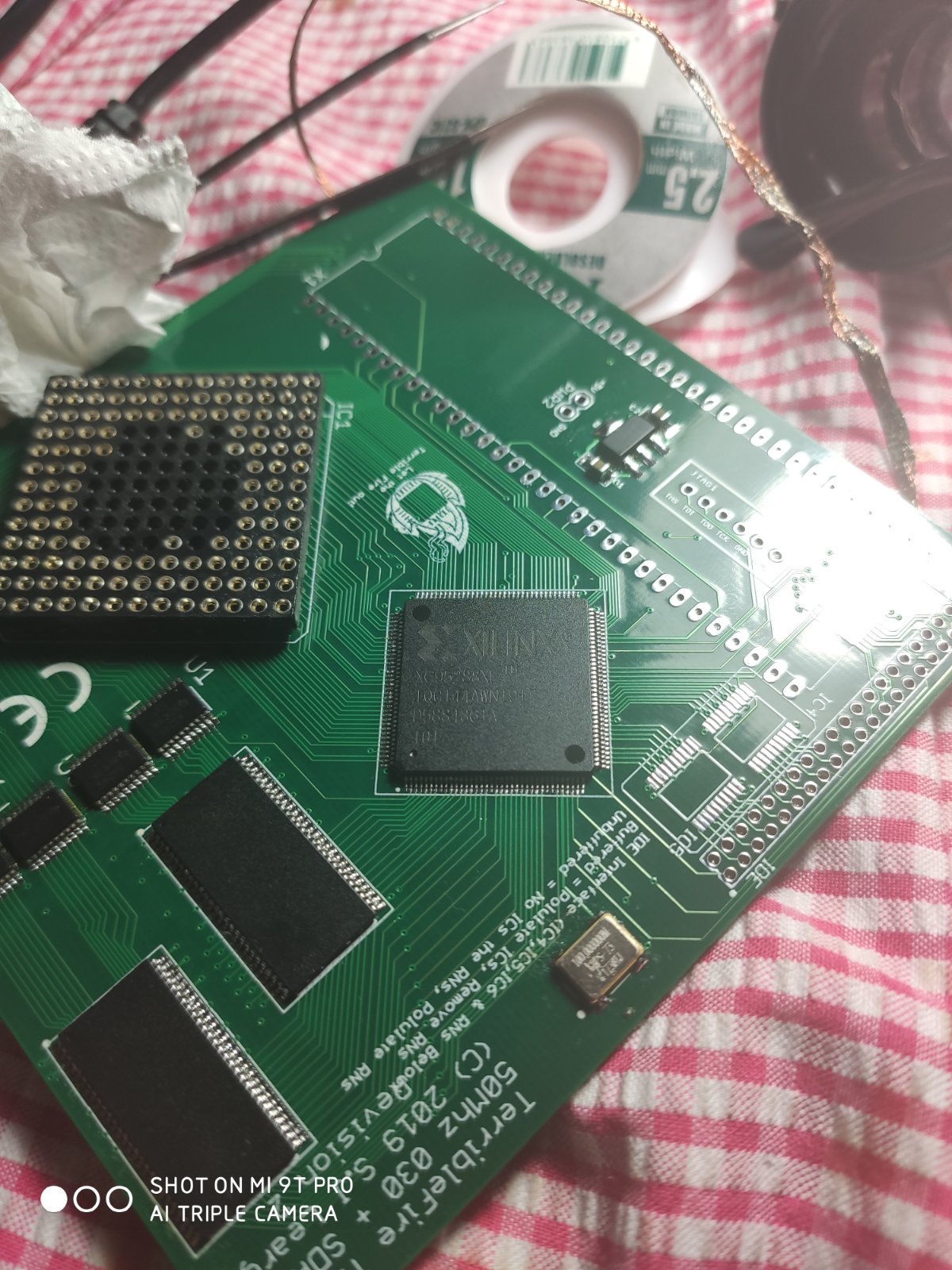

Just finish to solder
Just awaiting 2.2 rns

Beetween gng and 3.3 volts i measure 1.1 ohm is normal
Removed all ics exept cpld and measures 1 ohm or is board defect?
Unsolder all parts pcb defective short beetween gnd and 3.3
@ terriblefire need a new one
