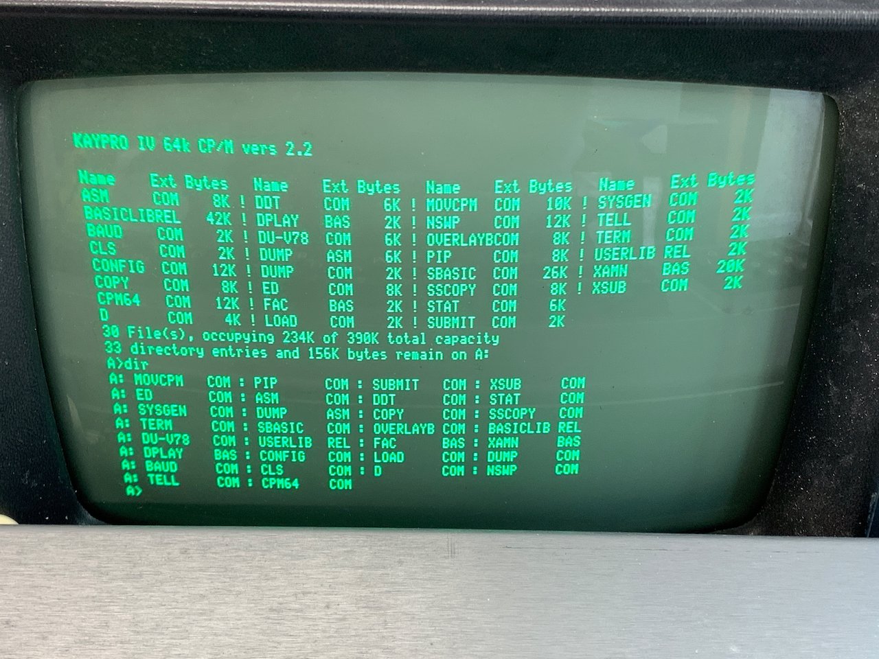

Re: General Stuff(tm)
OK, it's not the SIO chip... Next one along, the serial clock chip, the WD8116. Oh dear. No oscillation on the 5MHz crystal. Tried bridging an 8MHz crystal and nothing, which suggests it may be this chip instead... and it's a rare one.

Well, well, well...
Retrieved my Owon pocket oscilloscope from work and used the signal generator...
Firstly instead of the crystal, no go. The WD8116 chip is definitely dead.
Hooked it up instead of the 8116 output, going to the Z80 SIO port clock input... Nothing, not even bad characters.
Swapped out the SIO with one of the new ones... Strange characters... Tuned the clock rate and at 5KHz... BINGO!
So, BOTH the WD8116 AND the Z80 SIO were bad.
Actually, 4.8KHz is best, that's 300 Baud.
