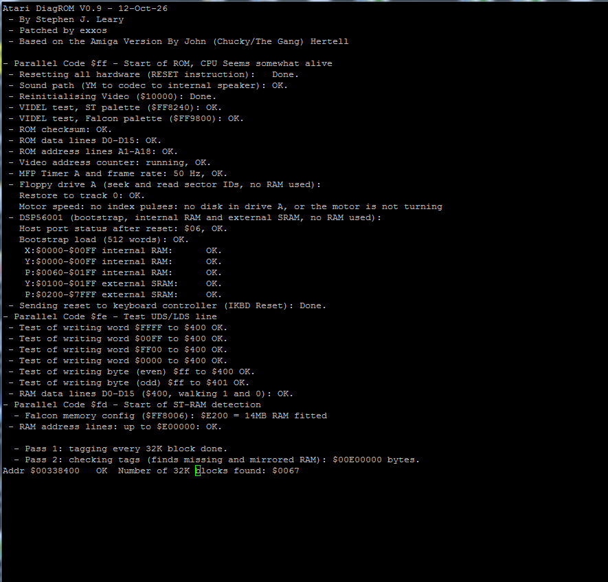

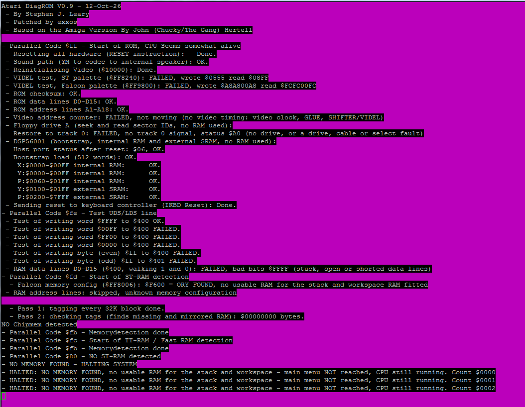

Adding more startup tests :)
Posts: 29870
On the dead falcon, excuse the background colour, the terminal didn't reset it seems.
So pretty impressive , the machine has zero ram and no videl and still can run a whole bunch of tests !

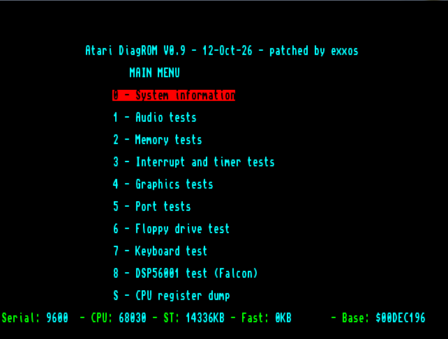

exxos wrote: Mon Oct 12, 2026 5:55 pm Muahahahaha... Claude saves the day in fixing Diagrom, still has some bug preventing it getting to the menu... BUT...
Oh cool. I tried to get Diagrom Falcon working a couple of times back when Stephen did his first attempt at a port, but I didn't actually need it at the time and so it fell by the wayside.
Will be grand if you can push the changes up to his repo.
Posts: 29870
Badwolf wrote: Tue Oct 13, 2026 2:19 pm Oh cool. I tried to get Diagrom Falcon working a couple of times back when Stephen did his first attempt at a port, but I didn't actually need it at the time and so it fell by the wayside.
Yeah, i'll stick it all on my github when its all tested. Most of it was either "broken" or Amiga stuff. So it's had a huge rewrite so far.

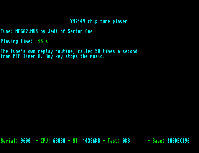

Getting buffer underruns on tracker CPU playback at the moment, so adding a realtime down sampling playback.. also adding a DSP mixing option to take the load off the CPU as well. Must have "blown" £100 on ROM's so far :roll:
It should work on the STE as well.. but that will have to wait. My room currently looks like a Falcon factory has exploded without adding STE into the mix ! :lol:
