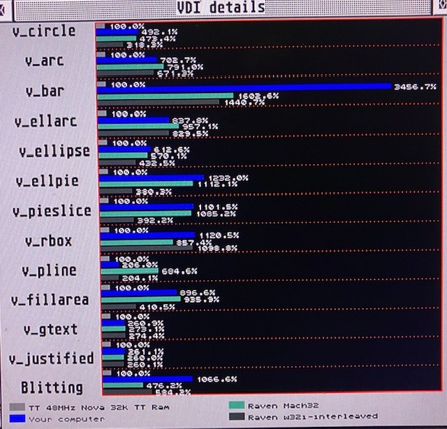

In an effort to accelerate some more VDI but with as little effort as possible I tested the lazy approach of hooking STA_VDI's internal line-drawer it's using when rasterizing primitives such as circles, polygons and so on. Basically calling my drivers generic blitter fillrect instead to make a line.
The result was slightly disappointing.
Setup cost ends up stealing a huge chunk of the gain, particulary when doing short lines as in the v_circle test.
v_ellpie and v_pieslice are both drawing quite long lines so while it's all very unoptimal, the setup penalty doesn't hurt as much.
I think the proper non-lazy solutions would be to implement dedicated linestrip support in the driver.
So instead of paying a setup penalty per line you'd get one per batch of lines.
Was planning on doing that anyway but for the purpose of using it directly from games (hardware assisted triangles), but VDI could in theory also use that by hooking it in a manner which takes a bit more effort.
One nice thing that came out of this experiment was it had me revisit the drivers blit function where I found some obvious things to optimise in regards to call overhead. v_bar in particular shows the result of that. blitting too to some degree but the slowest path was fillrect setup.
I found an old Mach32 benchmark and comparing against that makes me less disappointed about the lazy vdi primitive accel implementation.
They're actually in the ballpark on many of the things at least.
And to further reduce driver overhead I went ahead trying out the memory-mapped I/O feature of Cirrus GD5429/34.
Made a difference for sure being able to replacing slow ISA IO access with ISA MEM access.
