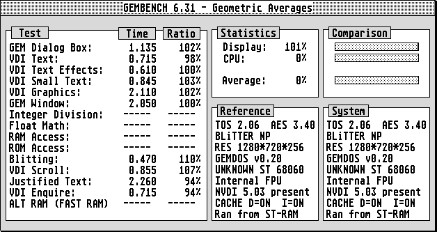

Oh! Very cool. I played around with it and turns out that my initial clock was less than $1c it seems as the following shot show some gains at $1c compared to previous stock.agranlund wrote: Sun Feb 15, 2026 9:09 am For now c:\rvga.inf doesn't contain very much but there is an mclk setting under the Cirrus section that can be fun to play with (@Atarian Computing )
Some vgabios can be quite conservative by default and my GD5434 can be overclocked to $2c before starting to poop pixels on the screen.
I saw that old Xfree86 mentions clocking up the '34 to $22 by default so I'm assuming most of them should handle at least that -- but our driver just leaves it at whatever the vgabios wanted unless you specifically set it to something in rvga.inf
Looks like $22 is the max my card can do without artefacts (that I can see so far).
