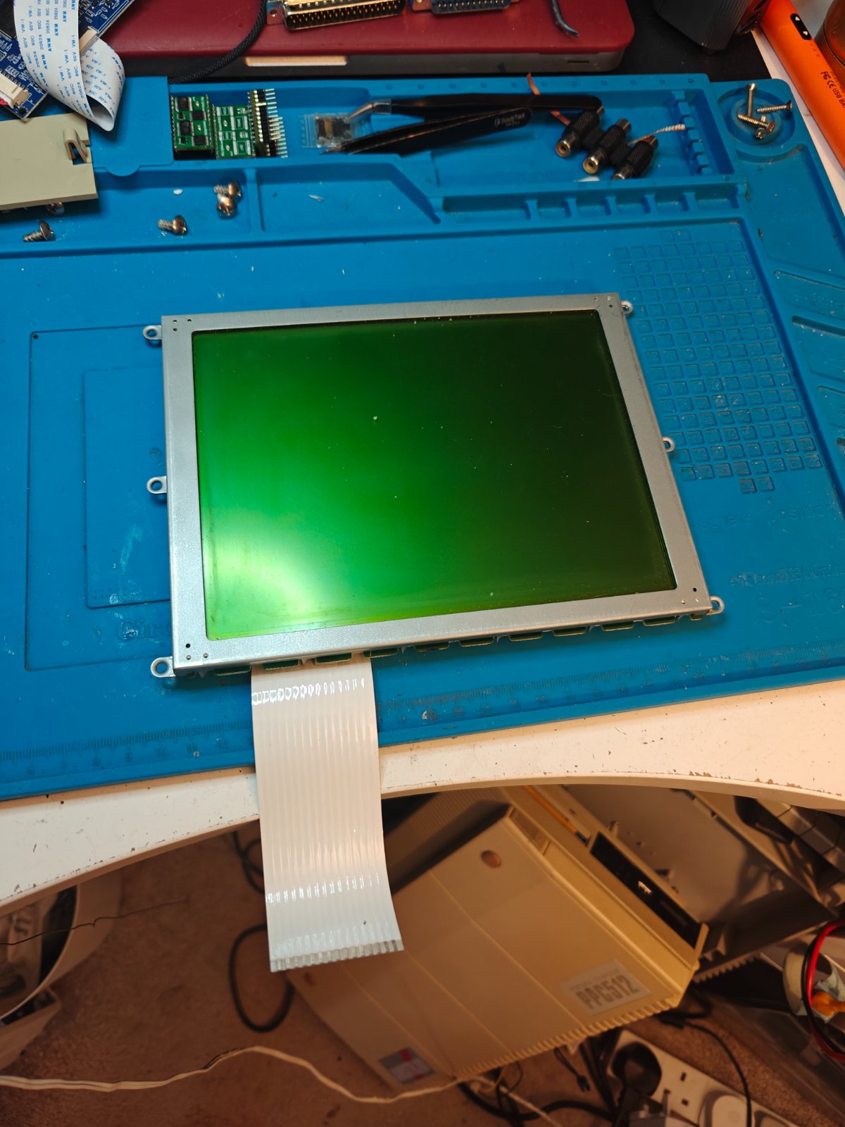

So the display is out and it's a chonky boy...
The huge modem is also out now to provide some space for the RPi and internal cables:

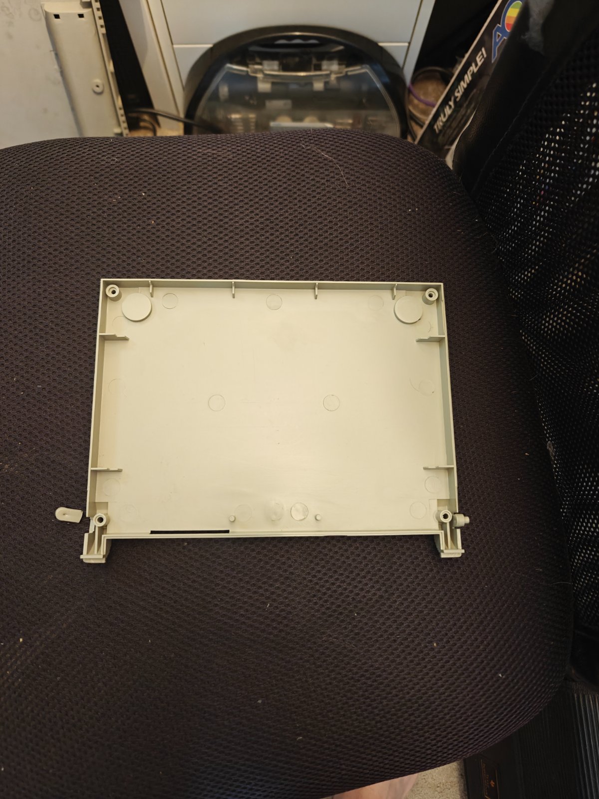

And as I said the plastics need some help:
The broken bits are what the entire display pivots on, so need to be solidly repaired before I can progress.

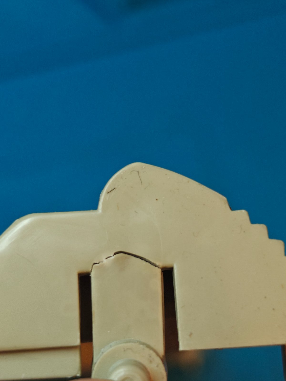

OK, so working on repairing the pivots is tricky.
They are difficult because they are supposed to flex, but don't, I'm having to key the surface to try and get the grp to stick:
But that reduces flexibility and makes things harder, so I need to figure out how I/m going to make fitting easier and the pivots less likely to fail when I try.

Have you thought about melting the plastic to weld the side which will get the most tensional stress in addition to glue?
- Posts: 15416
Re: A new arrival - Amstrad PPC512
I have, the trouble is it's all very brittle, it's a bit of a fight. I'm just re doing one and am considering melting in some metal pins to add to it before I add the GRP on top.stephen_usher wrote: Wed Jul 22, 2026 1:28 pm Have you thought about melting the plastic to weld the side which will get the most tensional stress in addition to glue?
In fact I just did the pins
Also, on the left hand side there is a guide down which the pivot is pushed to insert it:
If I extend the hole to about halfway up then I can push it in with minimal force so less chance of another break but gravity will hold it in place during use.
I really don't want to push it too far, but I do need it to go back in. Can't believe both pivots broke off in the end.

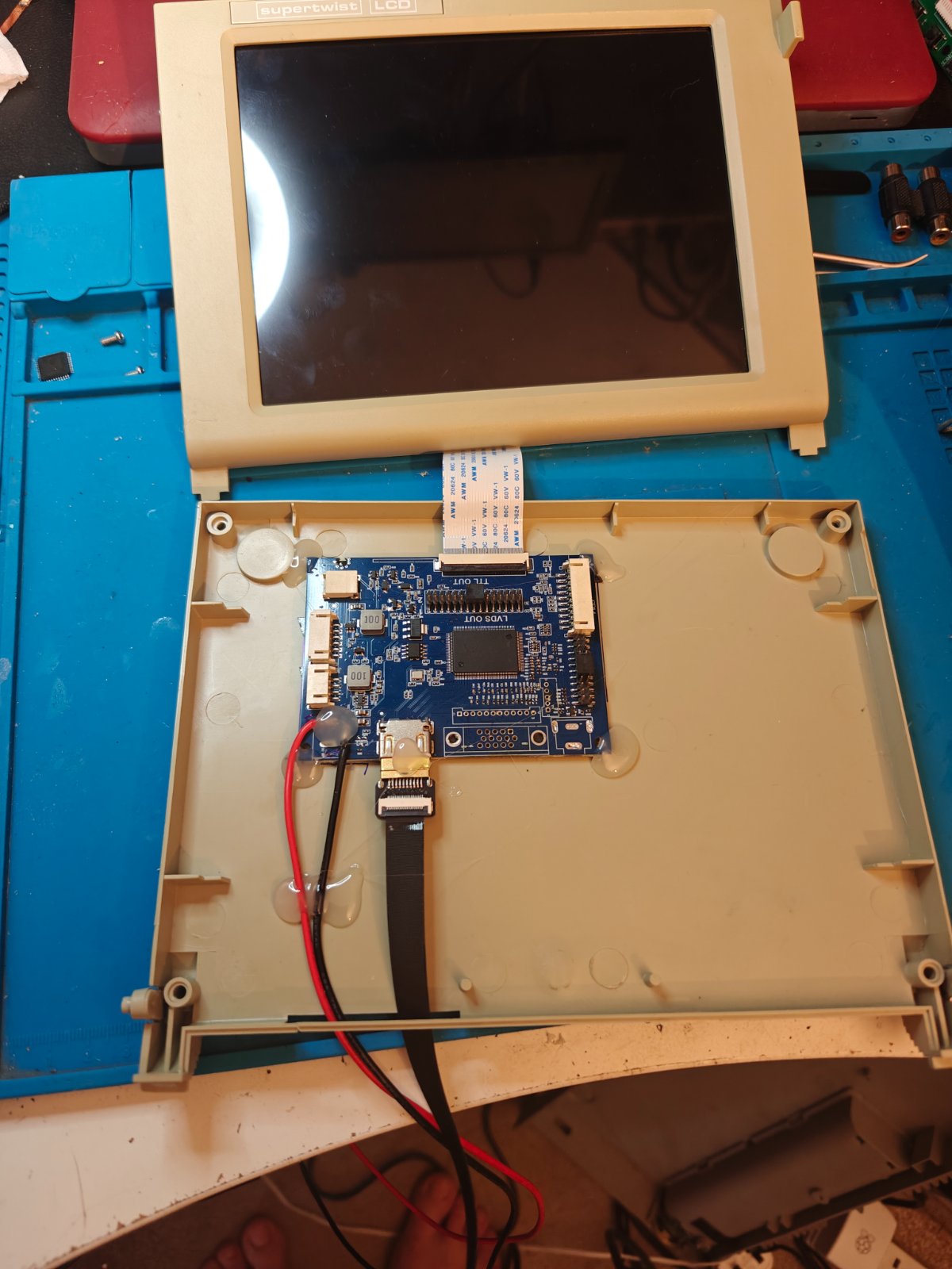

So the FFC arrived and works just great
Here are the display internals:
And the display all reassembled:
This is just to prove the completed display works before I reassemble the display into the PPC512 and is a RGB2HDMI test pattern.
Yes, there is quite a bit of hot glue in there but that is simply to stabilise the install, which was done with double sided tape. With the hot glue there should be little scope for movement in all the parts whilst remaining flexible.

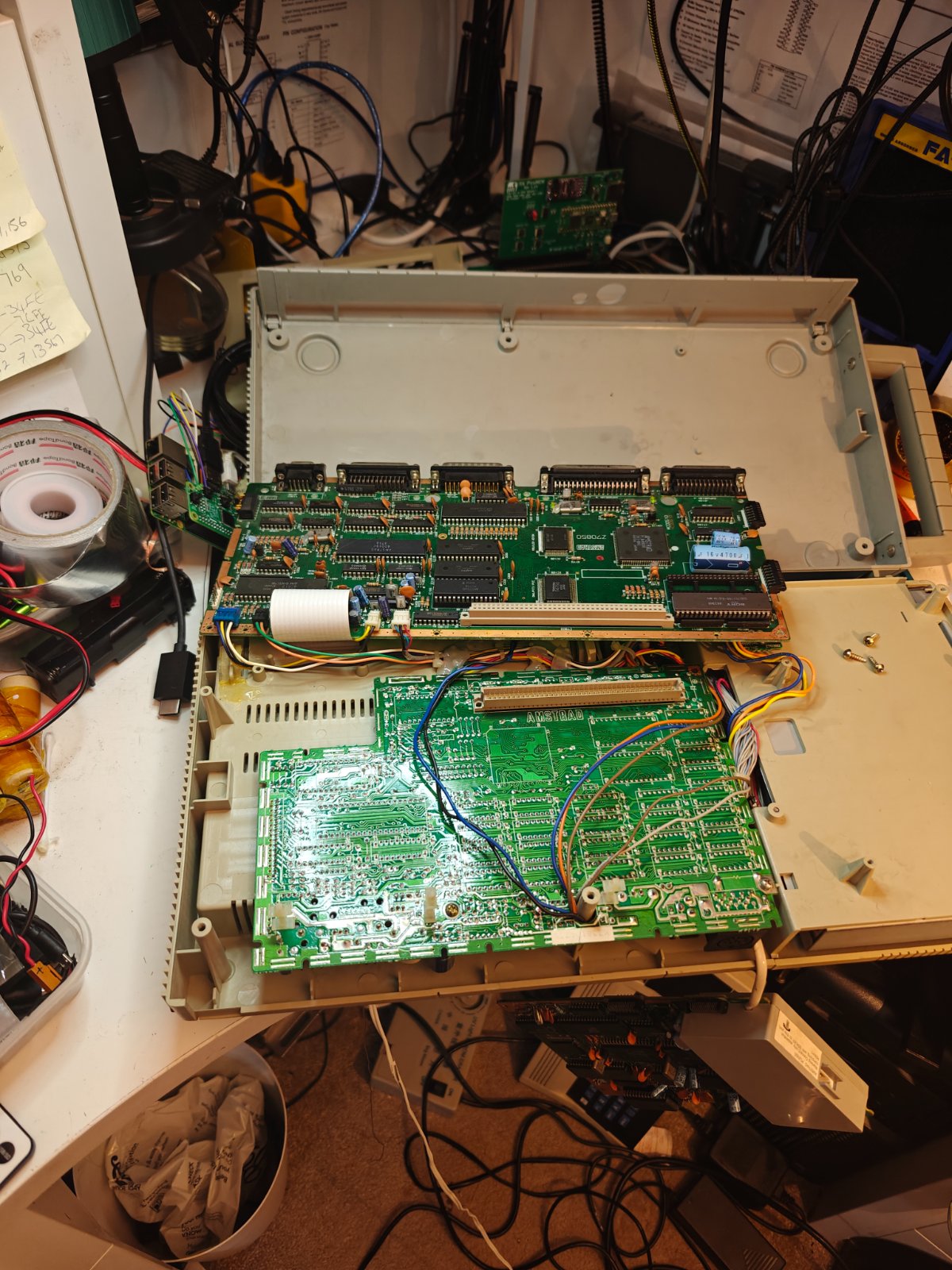

So the internals are all in place and the RPi and display both have 5v.
So all I need to do now is hook up the CGA port internally to the RGB2HDMI and providing all the video wiring is good then I can close it all up

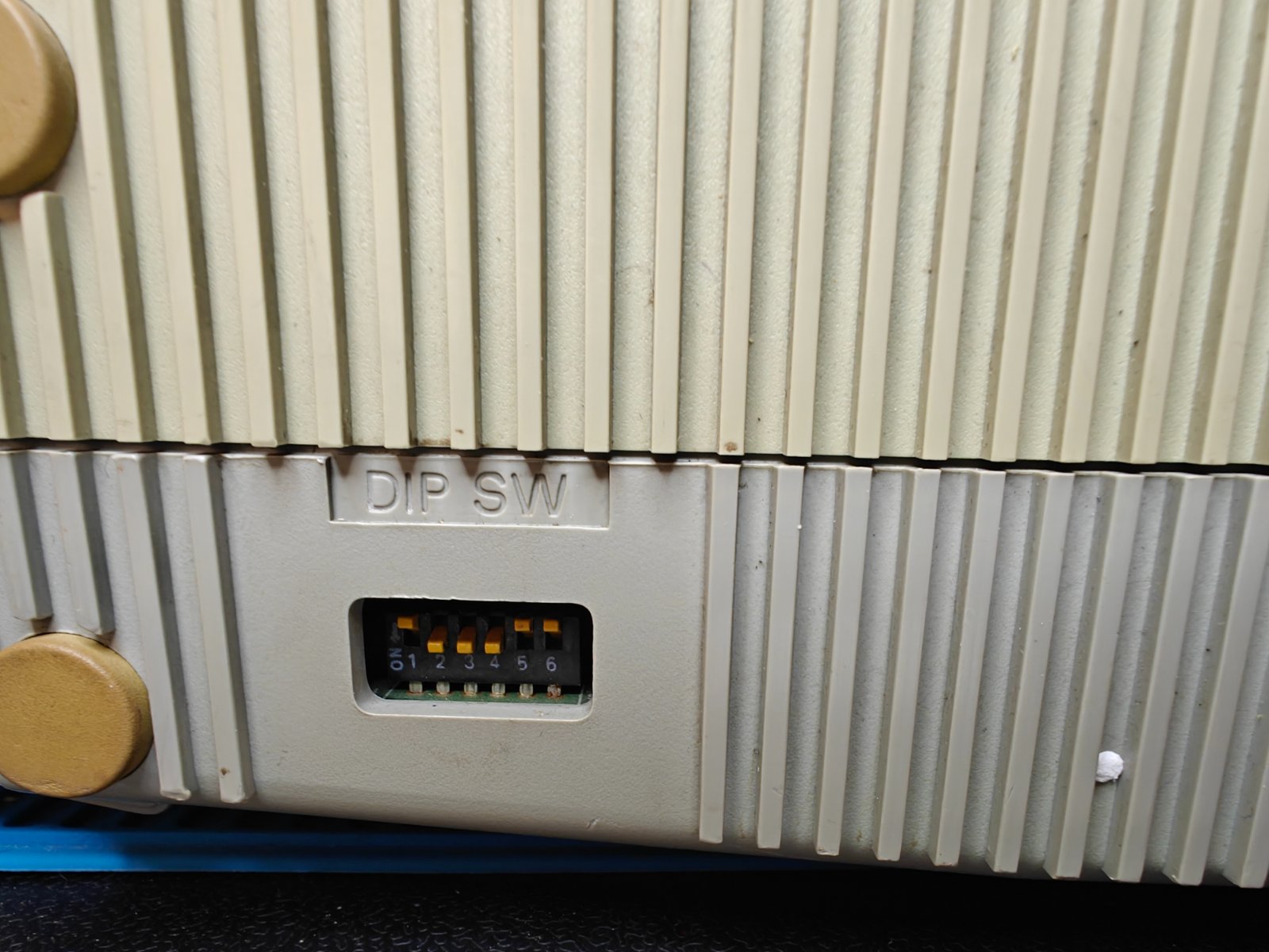

Incidentally the DIP switches on the LHS need to be set like this:
They are labelled 1-6 starting on the left side of the switch and are as follows:
1 - Off
2 - On
3 - On
4 - On
5 - Off
6 - Off
This is the position required for 80 column text and CGA external on.
There seems to be some discrepancy with the switch position for 1 in the manual, it appears to be the opposite of whats stated.
Nonetheless, these are the switch positions that work.
1 - Off
2 - On
3 - On
4 - On
5 - Off
6 - Off
