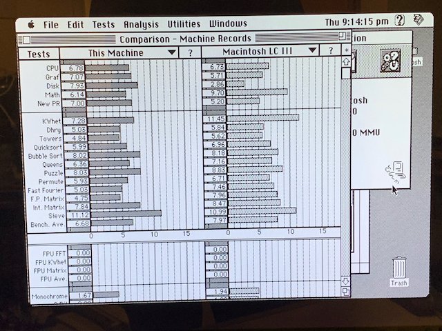

Beware Speedometer's disk speed test.
I set the disk cache under MacOS to "default", which for my machine became 1.4MB as I have so much memory available.
With the original 32K cache, 0.42, with 1.4MB cache, 7.93!
Oh, and I note that the Mac thinks that there's no FPU.

Re: Basilisk II Atari
Ah, yeah that makes perfect sense! when it has to jump around a lot any cache will have a much harder time.Badwolf wrote: Thu Mar 17, 2022 8:31 pm I've an idea about the disc speed -- I wonder if we're seeing fragmentation in the virtual hard disc as the first 2x figure was after I deleted a bunch of things from my old hard disc.
I was meaning to enable it now in the build that removed the 64MB ram limit but as I gave it a quick test I don't think it should go into a proper build yet. I'm happy to share one here though if you want to try it out.Badwolf wrote: Thu Mar 17, 2022 8:51 pm I prepared a raw partition to play with but then realised Anders' note in the README disabled both that and block device access.
The main issue is that the block device disks are "unblessed" if MacOS is not shut down correctly and that gets annoying real fast.
I'm not really sure why yet.
Speedometer disk speeds on these are at around 1x or slightly above, but startup speed and just general snappiness of the desktop appears to be better than disk images that score higher in Speedometer. I haven't actually timed anything to know for sure though
At boot, it reads mostly 512 byte chunks from a bit all over the place. Speedometer seems to be doing "large write", "small read", over and over a whole bunch of times to measure the speed.
