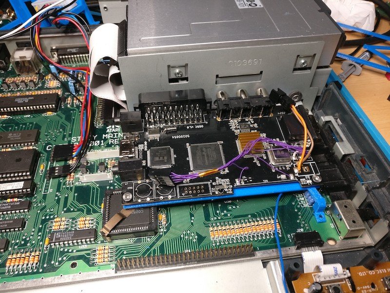

Little bit of progress made today...
Bracket for the OSSC. Yes, it's lower in the front than in the back. I have to tilt the board a little bit to fit it in there, and remove a few components off the OSSC.
OSSC installed on the bracket.
Keyboard installed, with about 1 mm clearance. Believe it or not, nothing is touching anything that it shouldn't. I'll still install some insulation in the final product, to be sure.
