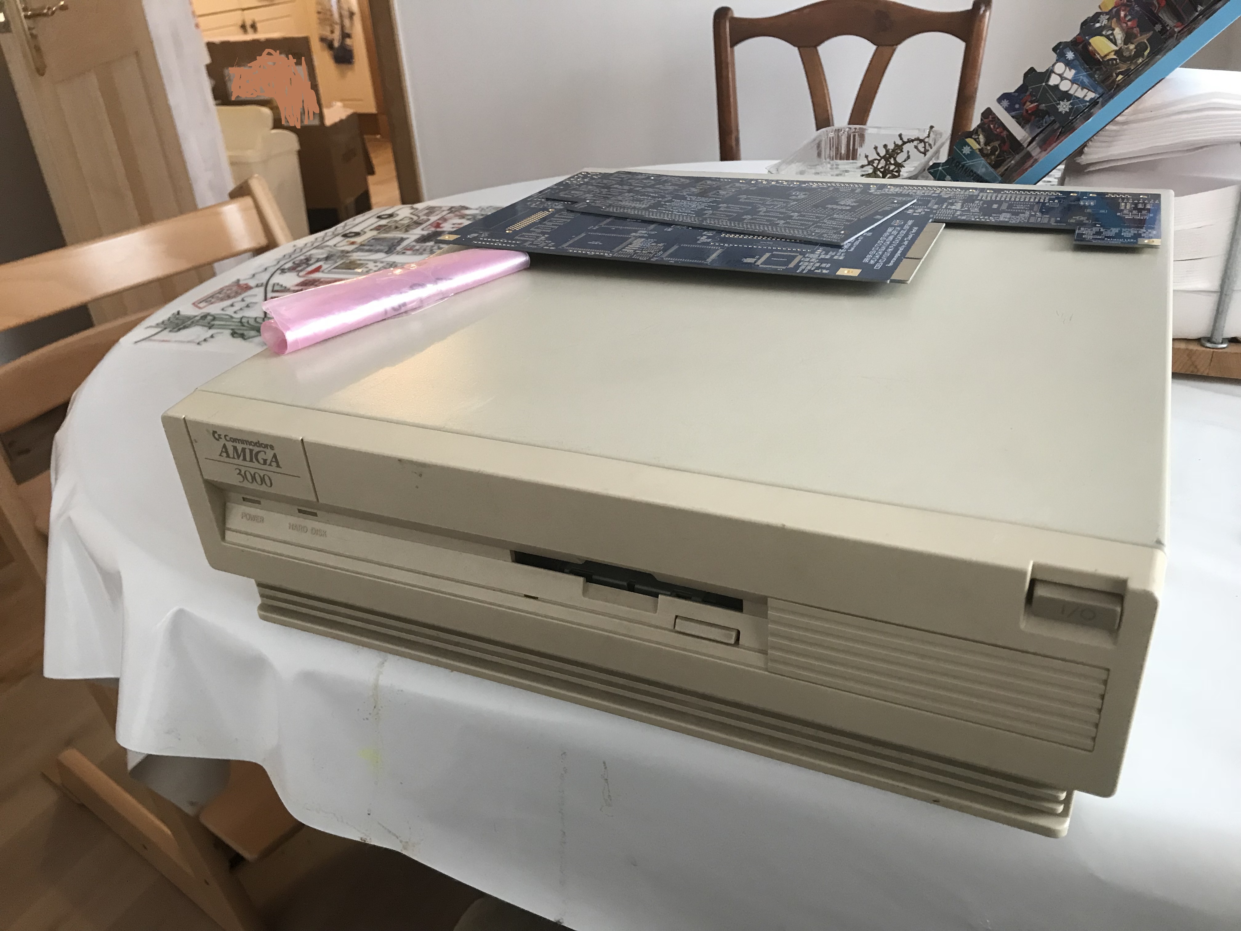

This pile of trouble arrived through the door...
And i've not even fired up the CDTV yet.
8 Bit Dreams
Moderator Team
Moderator Team
Posts: 785
Joined: Fri Nov 09, 2018 7:12 am
Location: Germany
Re: Terriblefire Accelerators
Post by 8 Bit Dreams »
Wow!!!
This one is nice! :P
