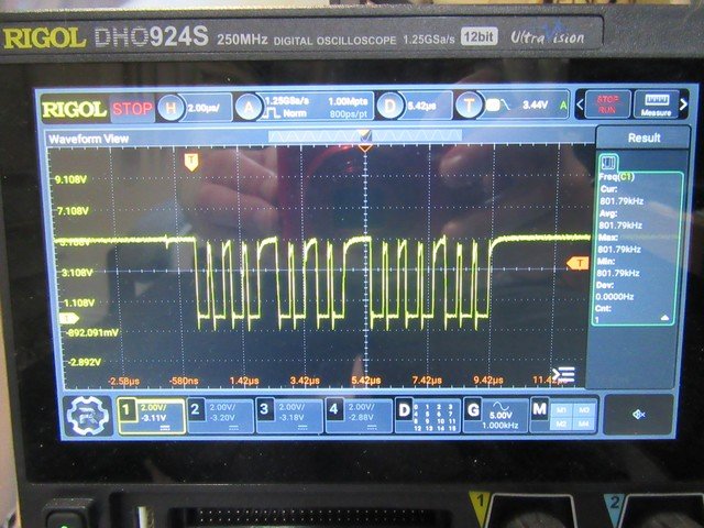

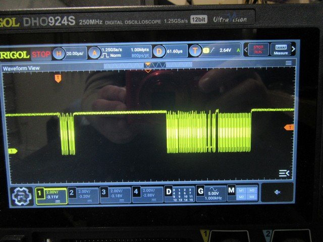

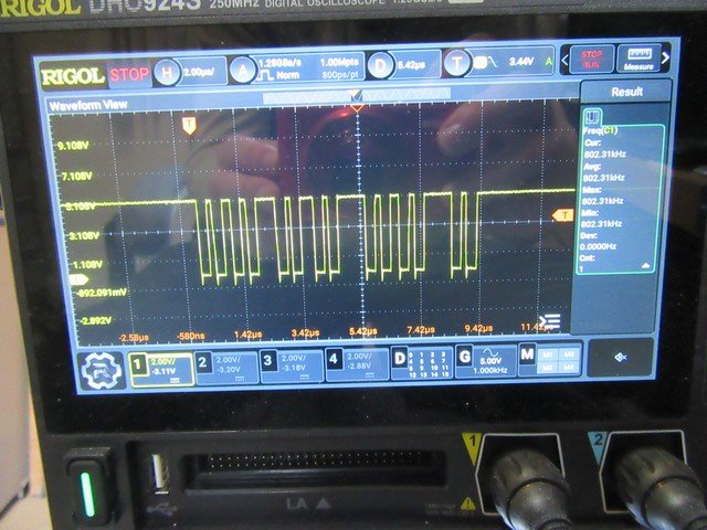

Serial adapter came just. Verified it worked on my own Falcon.. So it seems a Falcon without a Videl doesn't appear to want to do much :( So thats super annoying !
Got the scope on XAS and ROM CE and does at least seem to be some signs of life..
RESET doesn't seem to go low for a second time, so it doesn't look like its getting as far as issuing the reset instruction from ROM, which is pretty much the first instruction it runs from ROM.
Posts: 7749
Joined: 23 Mar 2018 20:22
Good that its got some activity, like its waiting for its next link in the boot up chain.

Well thats odd. Unplugged the diag-cart, then nothing on XAS at all.. plugged the cart back in , still nothing. :roll:
Now theres more activity :WTF:
