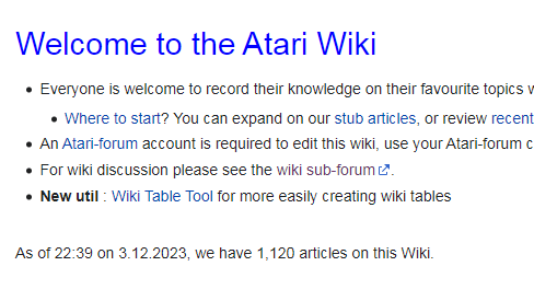

So I had to upgrade from 33 to 35 first which was almost pointless. Now upgraded to the latest v40 :D Will do some tests tomorrow see if it all still works.
Looks like the article count went down for some reason. Though it is only 4 less than the temlib one. It is possible for articles could have simply been lost or the temlib count is wrong. The thing is I actually added a few pages so.. No idea.

OK so I have no idea what happened here. temlib copy vs the updated wiki now...
