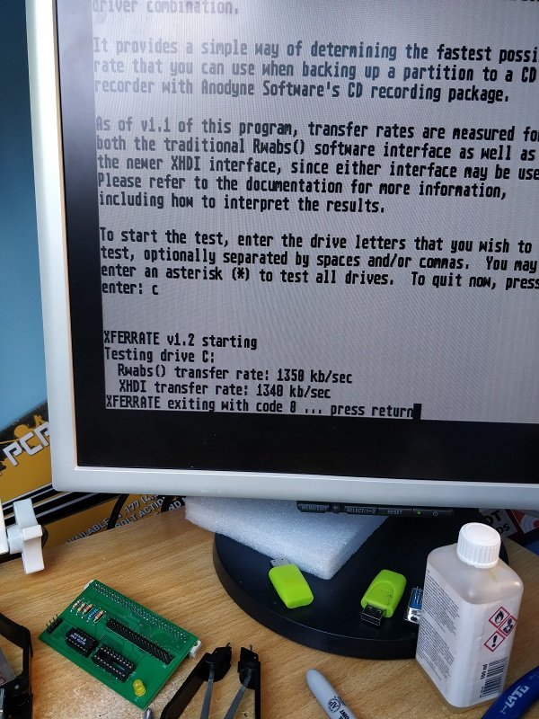

Despite the best efforts of my Mega4 to put me off testing the Megabus IDE interfaces, the Mega1 came to the rescue, and despite being TOS 1.04 and needing a boot disk, it ran fantastically:
With a decent xfrrate result too. Despite having only one GAL (More are on order), I was able to test both by swapping it out and I had no problems with either, and HDDRIVER running well. I tested with both laptop hard drives and CF cards and had no problems with either.

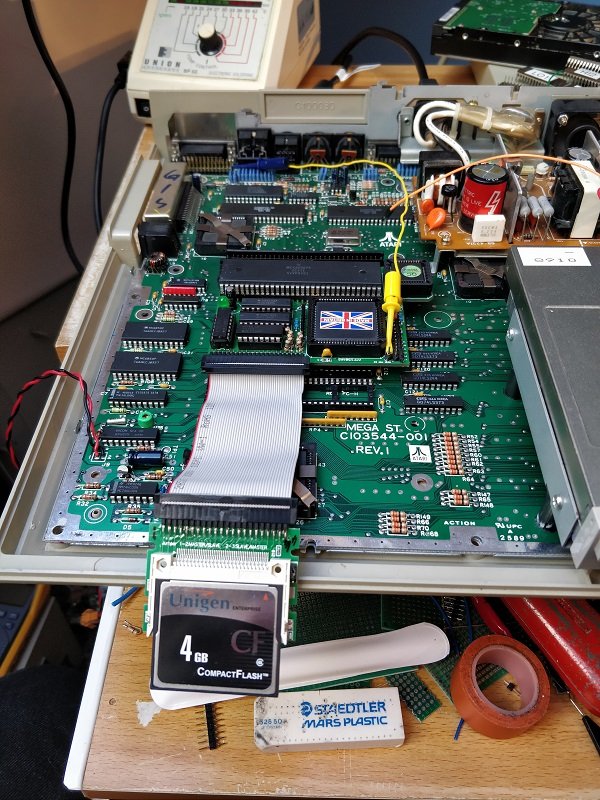

I also tested the V1.1C in the Mega1 and it works nicely too:
The footprint is much smaller and it works great with the small CF adaptor, and the smaller footprint of the V1.1C means there is definitely room for the support pillar. Just need to finish number 2 now.
