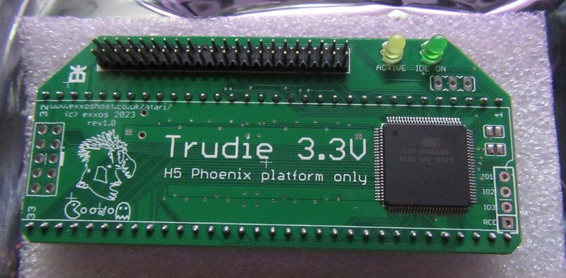

Some time later...
Found I had 50 of these made by PCBway back in 2022 ! It was a real PITA because of parts shortages etc. tracing back the costs of all the parts and assembly and whatnot is going to take some time to figure out after all this time!
So this is the first one ever out of the bag !
I remember I completely rewrote the firmware towards the end.. I think I was plotting to put in 5volt protection so people did not blow them up but I think it was proving to be more trouble than it was worth.

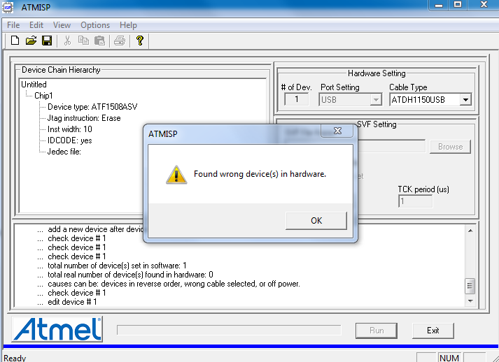

The notes in my firmware don't seem to suggest anything is not finished.. So I just need to compile it and actually do the final testing...
Nothing is getting in my way this time.. The world can burn.. I'm not getting sidetracked this time !!
Well that's a good start :roll:
This likely means these PLD are fakes :(
:sigh:
