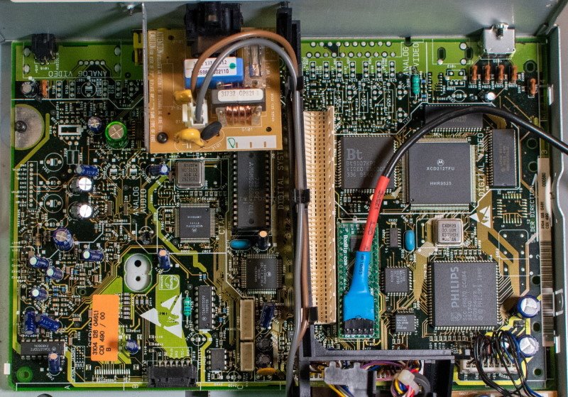

Post by rosewood »
I'm using this emulator to program/switch the system ROMs of my Philips CD-i players. It takes ~6 seconds to program a ROM and is way faster than a regular EPROM program and erase cycle.

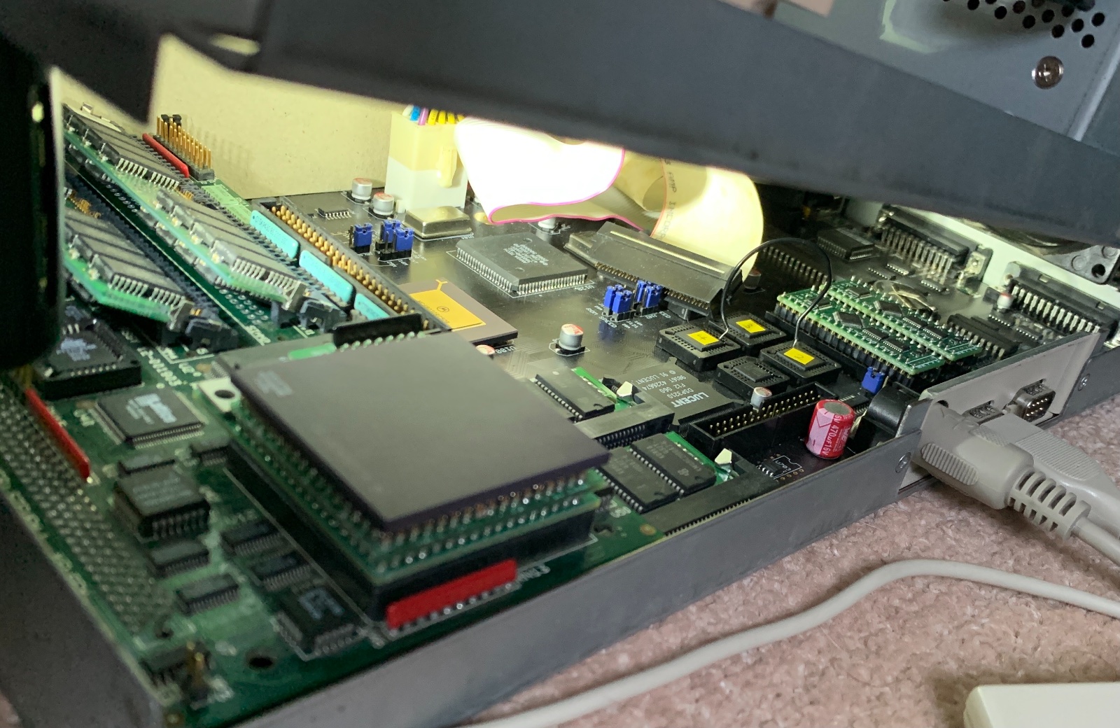

Post by trixster »
I thought I’d post to say that these eprom emulators have been great for use in testing different Amiga kickstart roms with DSP compatibility, so thanks again cmorley
