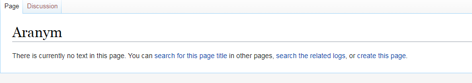

I seem to be going down the rabbit hole a bit now
The compact is listing page was missing. Though on temlib there was a edit in 2012. However in the database I got, last entry was actually 2006. So some entries have been completely deleted from the database (not by me) whereas the later copy actually exists on temlib.
So I am going through the database I have and then temlib to try and find whatever is the latest version.
I'm finding the quickest method is just to rename that page such as Automation999999999 because then the wiki will let me create a new page in that name. That way I can just simply copy and paste whatever copy seems to be the latest. Then just delete the renamed page.
So the top row is now the new entry and all the others are older ones. Slightly annoying as a timestamp seems to be missing from a lot of them.
So that *should* be other discrepancies found by the script sorted out. I'm still waiting for the log database to clear out

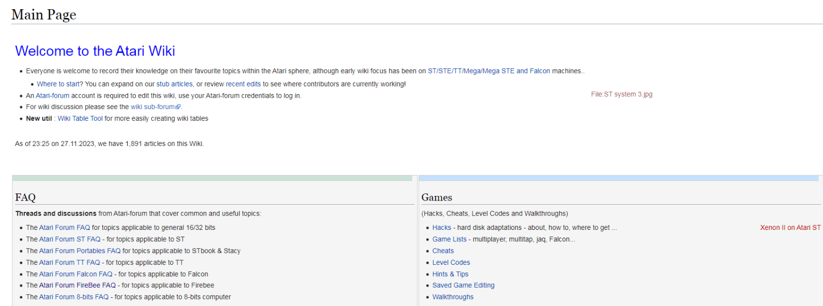

Re: The resurrection of atari-wiki.com
So looking around https://www.mediawiki.org/wiki/MediaWik ... own_issues which came from https://www.mediawiki.org/wiki/Topic:V35dno671xsssdgs
EDIT
So this didn't do much..
Did a load of stuff and ended with this..
Right, so V25 database restored. V33 wiki again.
Running update.php resulted in the main page and pretty much every random page clicked on is blank...
So did nothing then.
Did a bunch of stuff..
But still stuff broken.
At this point there is a belated updated script in which someone patched
gist.github.com/ciencia/7cbe63b8520d4816ec36733454a2cb9a
So I guess that did not work either.
running this 4949 rows before and 12489 after.
Now I clicked random pages about 20 times and they all seem to be loading now. Though the Aranym page still doesn't nor the mainpage.
running update.php again had now change..
But I guess it does give me a possible lead into what's wrong I guess
Oddly now clicking EDIT page in the wiki and saving changes resulted in the pages now showing! So maybe there is finally some light at the end of the tunnel!
So running update.php again...
So running cleanupUsersWithNoId.php ..
Then running update.php again..
Same crap still..

Seems after the V31 update 99% of the images have "vanished" now
The actualy images are in the images folder and I can see them if I do a direct link to it from the browser. All the image info seems fine in the database. Just they not showing.
I think something is fundamentally broken with mediawiki in versions over 30
One image which does work
Then one which doesn't..
Bizzare..
<img alt="AW3p20.PNG" src="/mediawiki-1.33.1/images/1/17/AW3p20.PNG" decoding="async" width="582" height="866">Code: Select all
