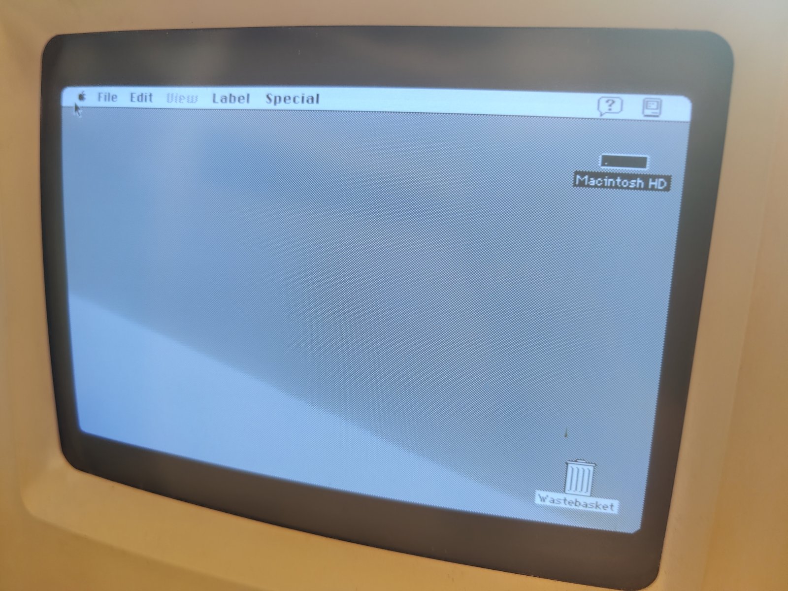

There's more:
Still some work to do, but it's a start. This is the mobo you sent me, so thank you very much

Re: Mac Classic - will it ever run again!!
And in no small part due to you Tom, thanks so much for your help and the mainboard, I'm very grateful.
Seems have been down to bad connections in the main plug and the power plug for the HDD, which was making and breaking and causing the PSU to hiccup. Gave them all a clean and a tweak.
Memory module installed and working too now:
I need to fit a replacement battery so need to find a cr2032 holder, sure I have one somewhere.

Not quite the same, the Mac has a 14 pin plug internally and I had already reflowed the connections for that and all other stuff, like video and sync to the neck board too. Plus the logic board was actually, and still is, dead.
The HDD power was odd, it kept pulsing and bringing the PSU down, but as soon as I sorted the Molex plug, it started behaving.
It seems that bad connections were rife in it though, as it took me another 30 minutes to clean the memory board and SIMM connections before I got anything other than a sad Mac.
Need to give the FDD a service I think, and add a non exploding battery type!
