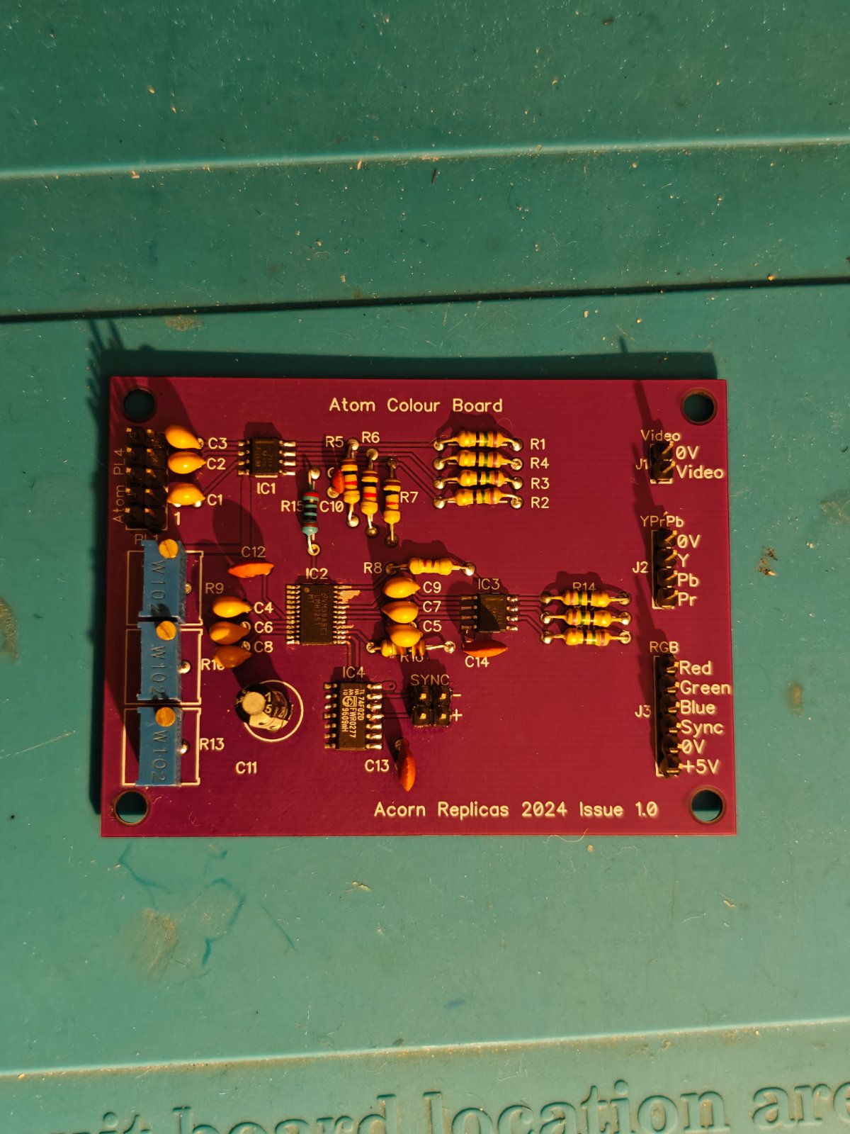

OK, so the colour board is built:
I've not had time for a proper test but it does a least output just fine via the composite output of the Colour Board.
I'll need to rig up something to test the YPrPb and RGB outputs next, but that'll have to wait as I'm up at 05:30 tomorrow and want to go to bed now!!!

Re: Acorn Atom Replica build
Well happily I have been able to check all the colour board otputs with my scope and everything seems to work as expected
I get good video/sync signals from RGB, and good video and sync signals from YPrPb and composite, so next up I need to try and get them hooked up and tested on a colour display

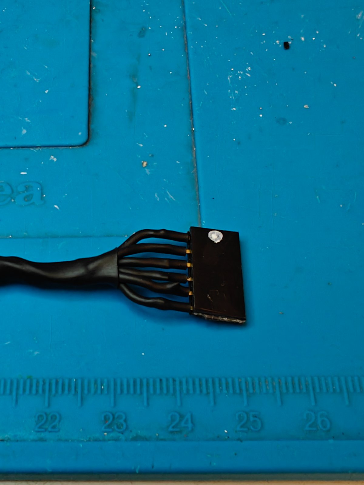

OK, so happily I have a spare 6 pin din socket that I can use to build an RGB cable for the colour board that will work with my BBC B RGB SCART cable.
Connections are as follows:
So it should be fairly simple to get wired up today.
I'll report back later.
- Posts: 15609
Cable made:
And it works!!! It is still NTSC though which my TV isn't 100% happy with.
