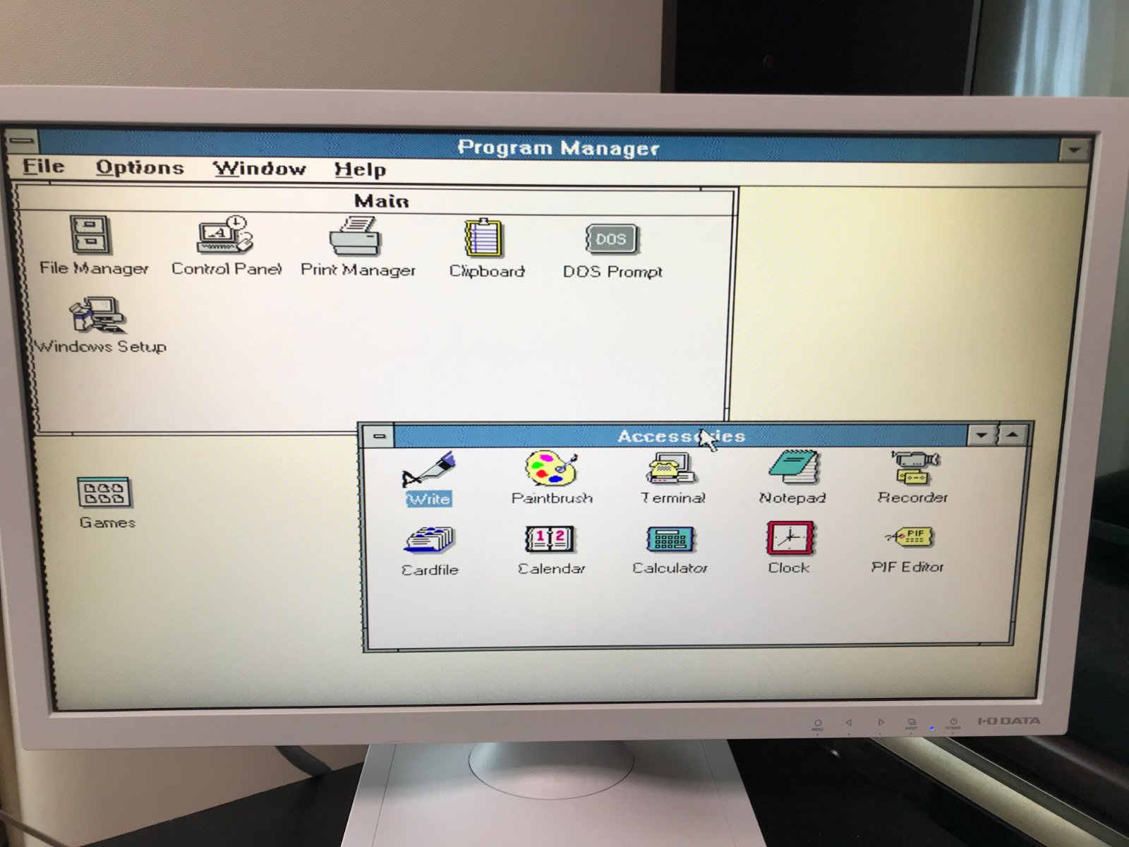

Serial port expansion finally installed. I can now use my Microsoft mouse.
Looking good and neat from the rear of the machine:
With the top lid closed (bulging a bit though...):
Mouse driver installed:
Some nostalgic screens:
And to summarise all the mods performed and bits installed inside the Tandy 1000EX limited space, here's a list:
