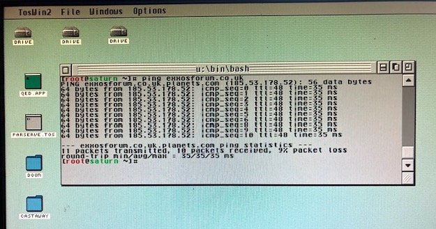

And that day was today
This is using the stock netusbee/ethernec drivers for Hades.
Since the drivers are open source it would probably make sense for me to make a custom one for my machine, to take advantage of ISA interrupts.
The original one is polling from TimerC.
And maybe also put the card in 16bit mode instead of 8bit to halve the amount of cpu<->card transfers.
