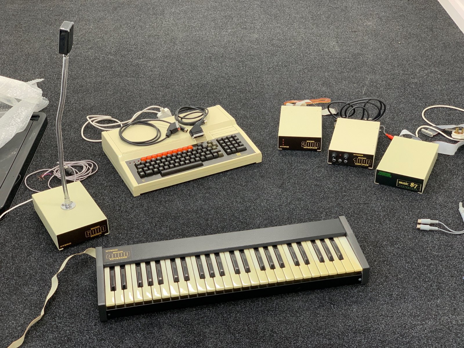

Yesterday I travelled up Leicester way to help the widow of Paul Vernon (https://www.retro-kit.co.uk/), along with another member of the Elite: Dangerous "fan club", to clear some of his collection.
In August there's an Elite Community Meet and one of the displays will be a tribute to Paul and as part of that they want one of his two Hybrid Music Systems set up, so I brought one home.
Now all I have to do if figure out how to put it together and get it working!

That is really very cool, I suspect you will be able to figure it out no problemstephen_usher wrote: Mon Jul 10, 2023 9:40 am Yesterday I travelled up Leicester way to help the widow of Paul Vernon (https://www.retro-kit.co.uk/), along with another member of the Elite: Dangerous "fan club", to clear some of his collection.
I heard about Paul some time ago, possibly through Stardot, I don't recall, but his website was a great resource and incredibly helpful when I was repairing the A5000.
A sad loss indeed.
I personally have a BBC B donated to me in memory of a work colleague who died about a year ago, it's amazing the connections you make through these machines.
