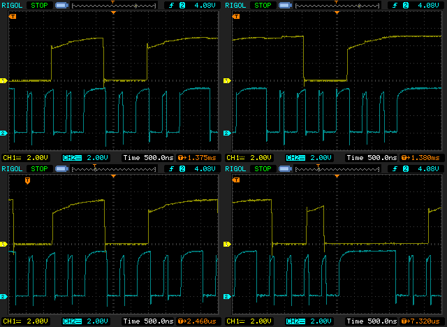

Today I tried to *finally* compare the good and bad Falcon's data/address signals which required learning about the long memory depth.
I have stitched A2 (yellow) and /AS (blue) together, first row = good Falcon, second row = bad Falcon:
We can see that bad Falcon's A2 falls down way later (about 1us), barely making it to the first /AS rising edge. Then everything is OK for 8 pulses (addresses) only to see that on the 9th bad Falcon barely makes a "1" and A2 falls down (it should not). Also, the 8th pulse is obviously way shorter on bad Falcon...

Re: How to diagnose dead Videl?
\o/
